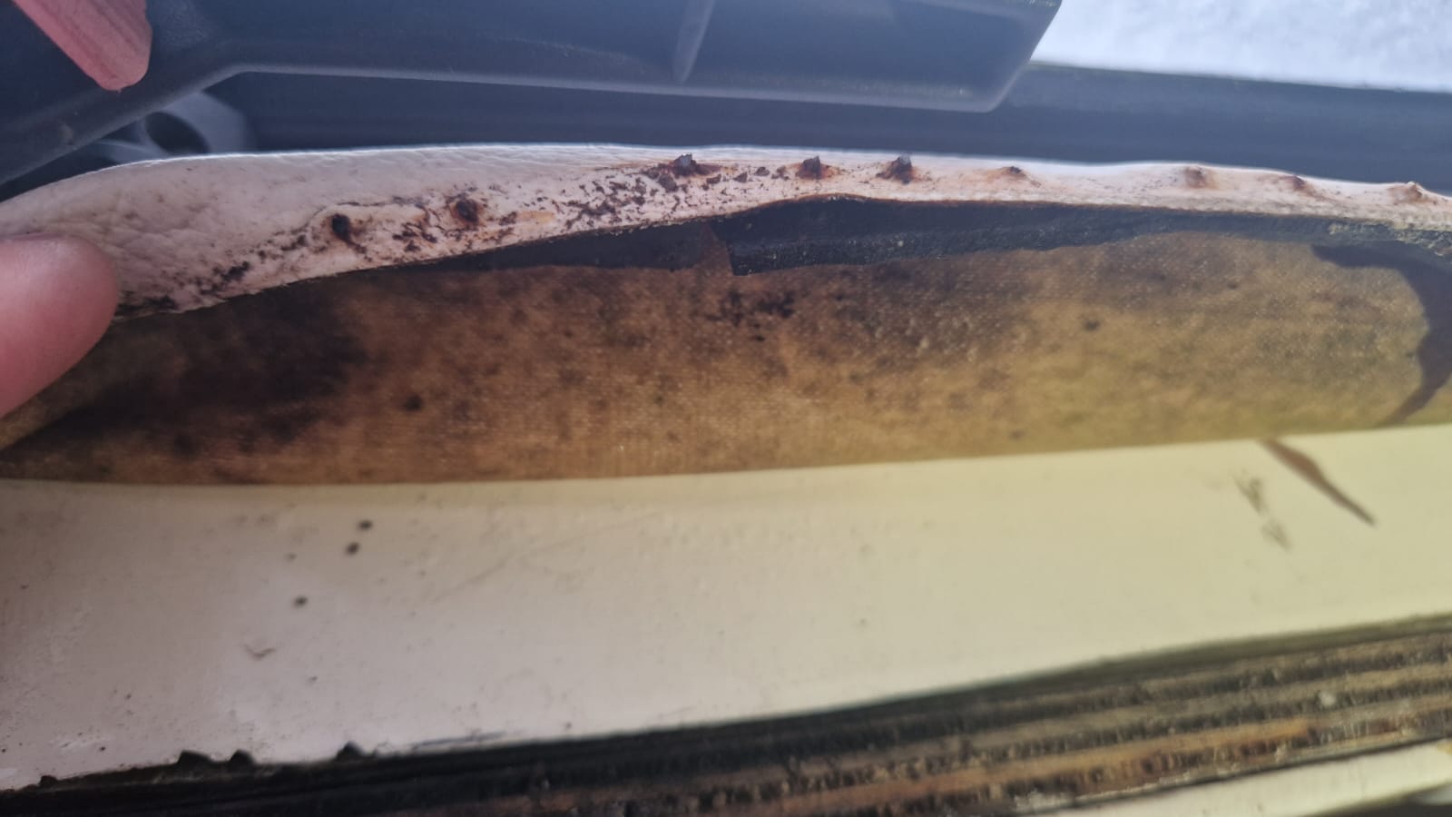

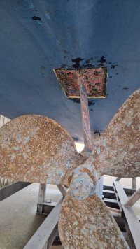

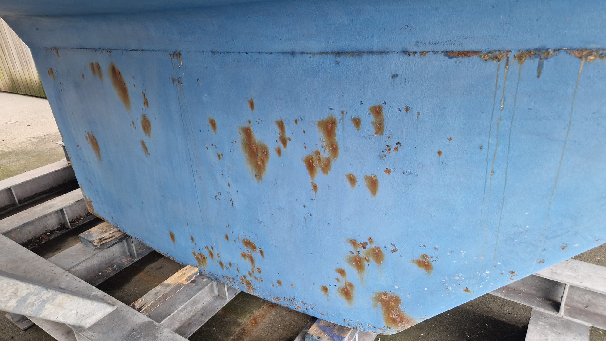

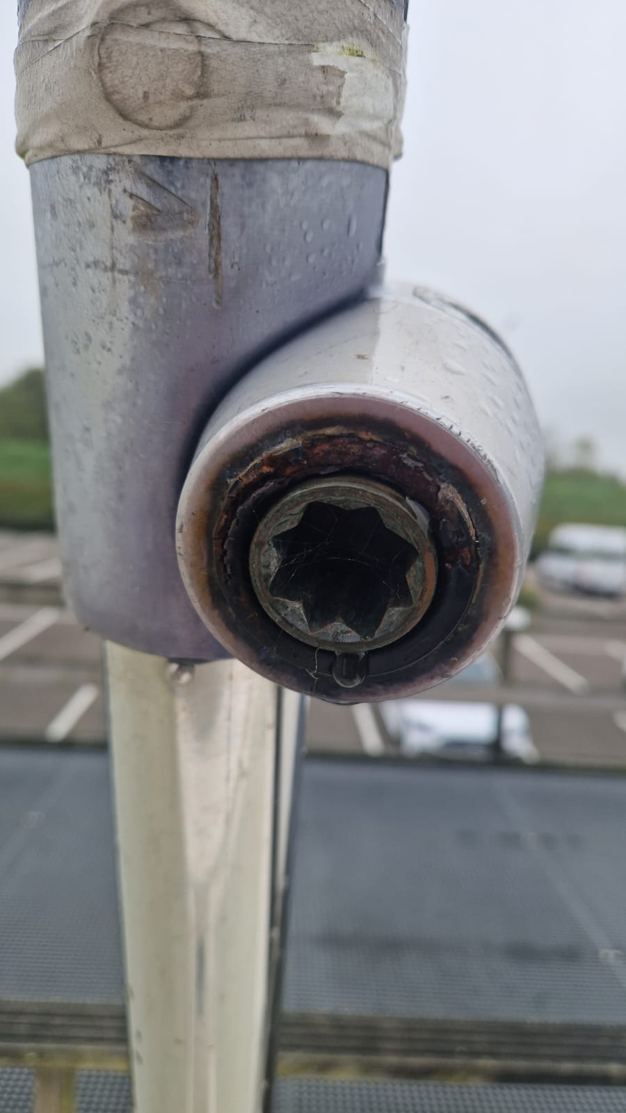

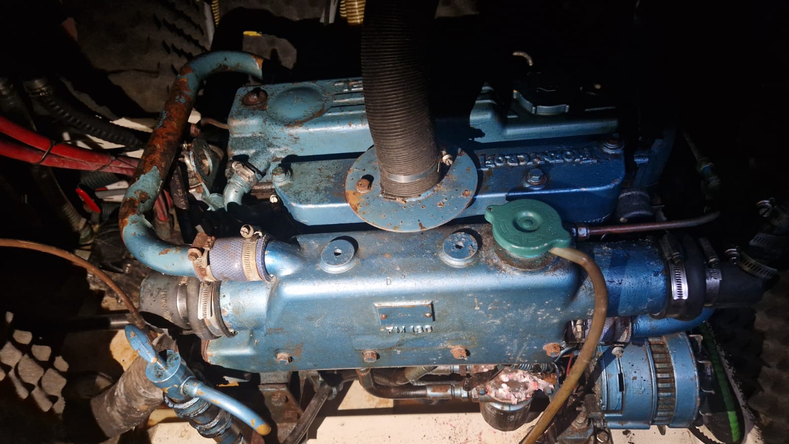

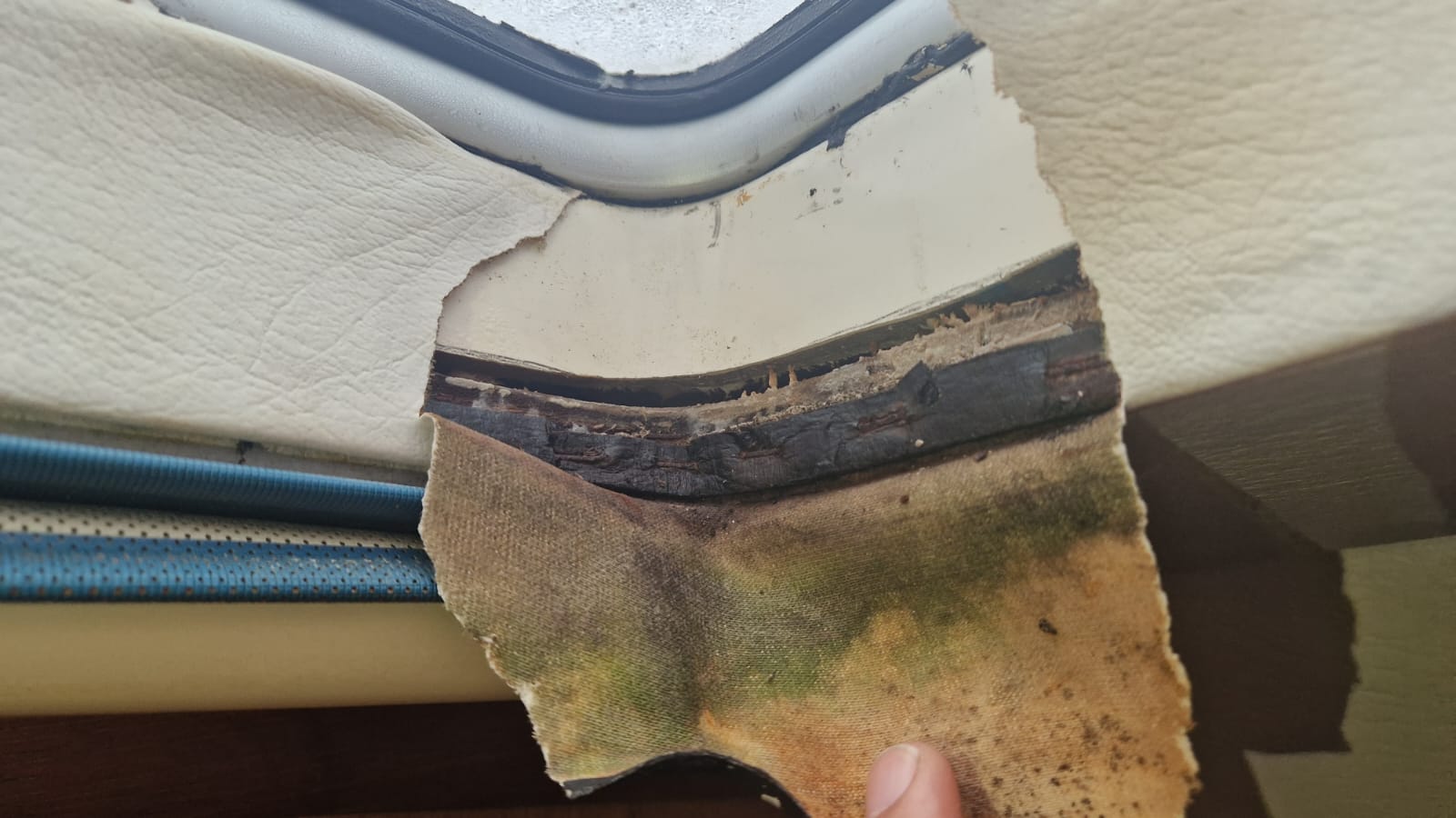

Hello everyone,
another funny coincidence.... we just visited the Moody 425 today and we are shocked. Unfortunately, we only now found this forum... otherwise we wouldn't have driven 5,5 hours to see the boat :-(
As the rainy and winter season is about to start, you can imagine, that the condition of the boat doesn't get better...
The boat is not ready to sail. All technical equipment (depth, speed, wind...) isn't working. In addition to that, for example, the fridge etc isn't working either. There is a lot of mold everywhere. The bed in the owners cabine is wet and molded. The motor and the keel are full of rust. There is a lot of water under the motorblock. Almost all the windows are leaking, the wood in the sandwich rots.... just to name some of the issues...
We'll leave the non-existent toilets etc. out of the equation ^^ (just why ???????).
It is so sad how someone can do this to his/her own boat!!!!
The broker is not very understanding, respectively the owner thinks, that it is made of gold ...? We are out.

Sad to see, but even great boats like Moodys will decay quite rapidly if not well looked after. I have often written in these pages that the value of a boat of this age has more to do with how well she has been cared for. If the balsa core in the deck is saturated, that is probably the defect that would worry me most, the rest of what is described here can probably be fixed for something between £30K and £50K, so the price needs adjusting for that. If the deck core is saturated, I'm not sure she is economically recoverable. Most boats die at some stage, just sad that this time it's a Moody which, with reasonable care, could have a much longer life.

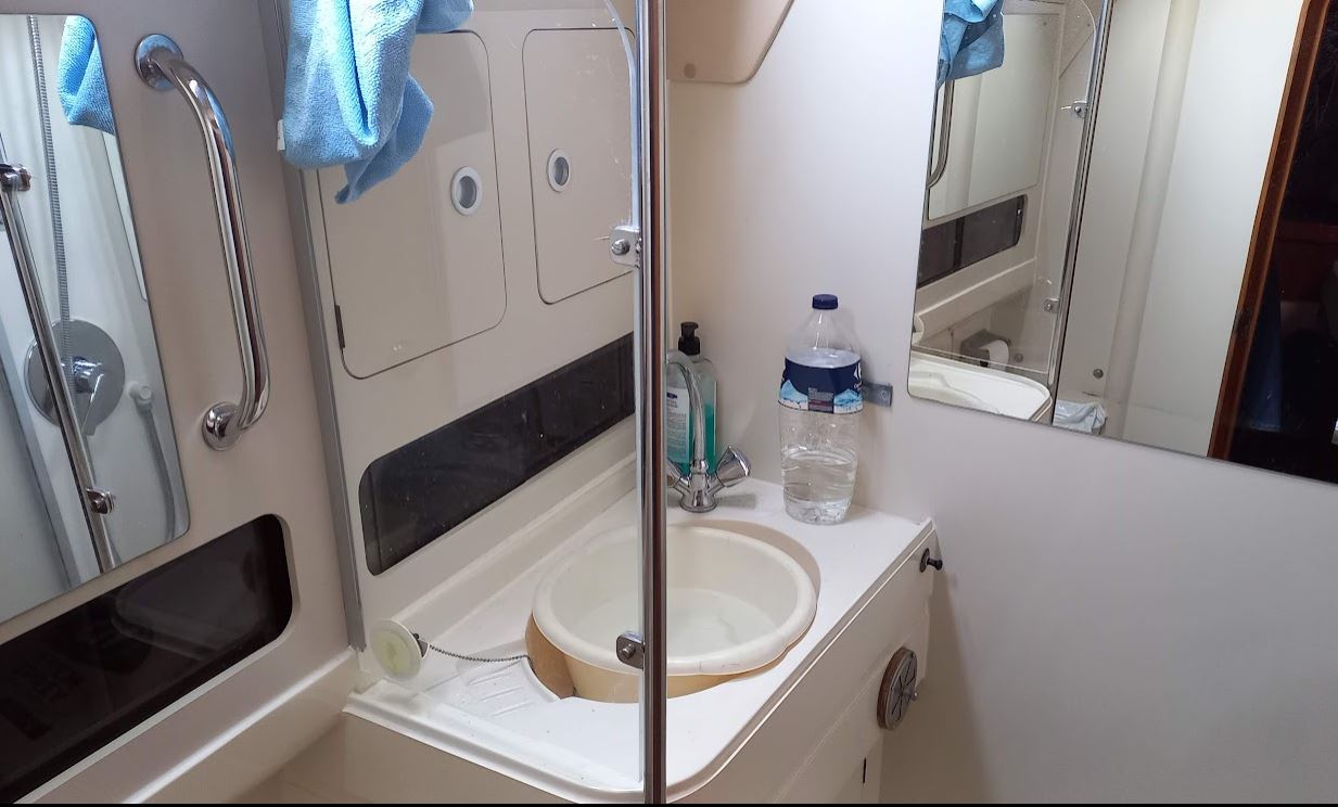

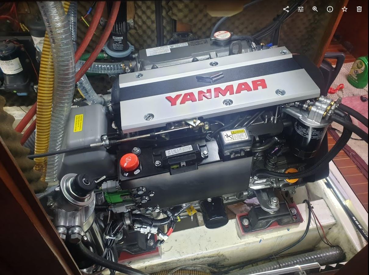

Have a look at "Lille Bee" a Moody 422 (1988 model) coming in the market any day now (EU vat paid). Lying ashore in Aegeni Greece. New Yanmar 4JH57 engine. The aft cabin is better than the 425, as the heads are totally en-suite. Both heads are good old "pump it yourself" types, both to their own separate holding tanks with and deck pump outs.

John, just be wary because the Yanmar 4JH57 engine is common rail injection. Which means that it is run by an electronic control unit & it needs a fault code reader to be plugged in to diagnose any faults & that means a Yanmar dealer as Yanmar will only supply their dealers with the readers. I was on the Yanmar stand at the 2019 Southampton boat show looking for a new engine & when I found out I immediately left their stand because IMHO common rail injection engines are not as repairable at sea because it is dependant on a Yanmar dealer.
