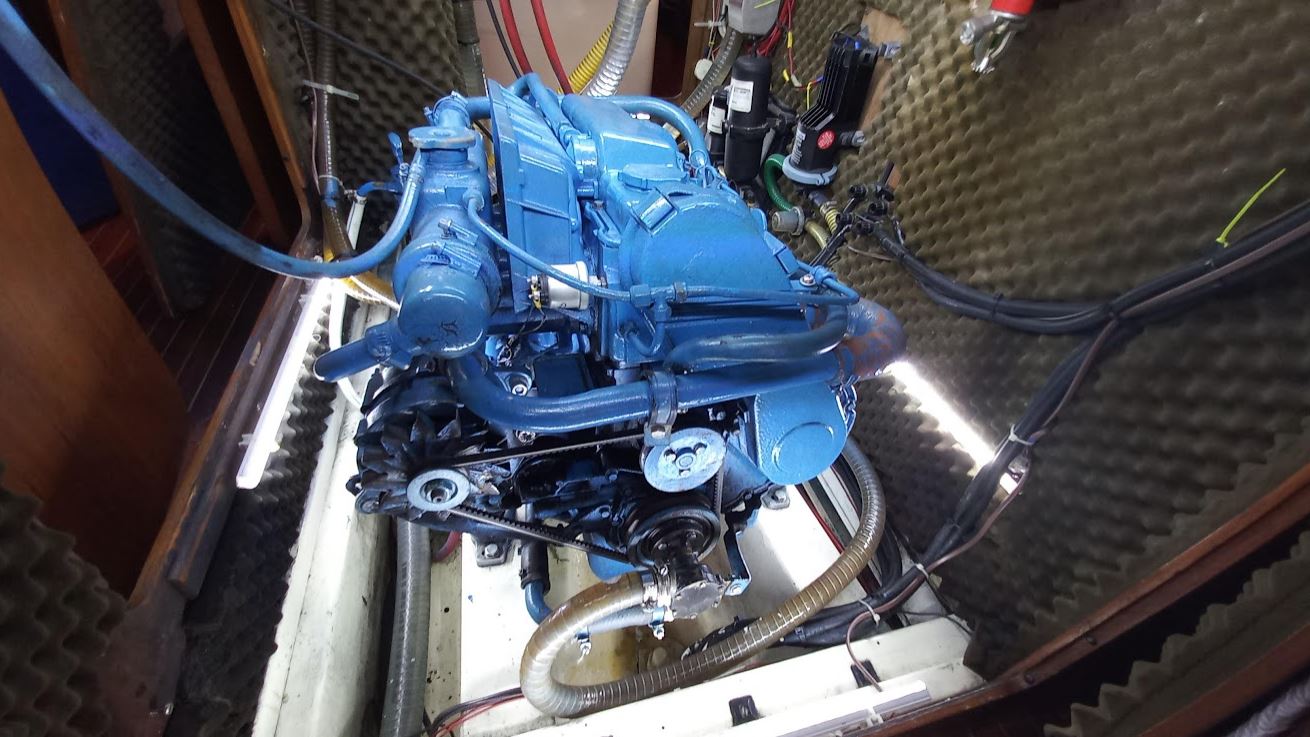

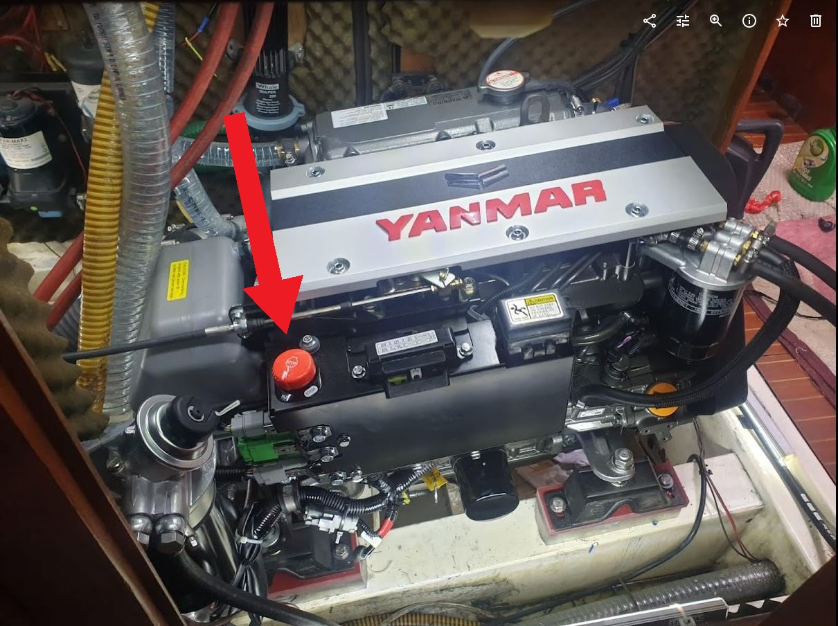

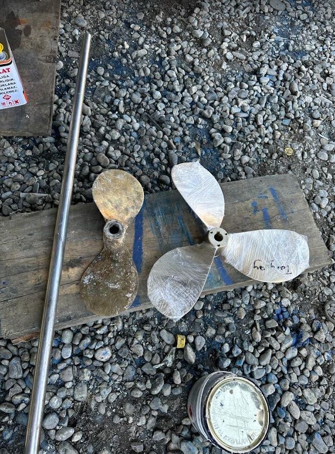

Having just replaced the old T98 Thornycroft (based the 1.6 litre Ford escort) with a new Yanmar 4JH57 in our Moody 422 all I can say is, the old beast served well for 35 years. However, the replacement bits were just getting too numerous (water pumps, oil cooler, exhaust) and expensive, I could go on. The most noticeable difference has been the performance though. Same shaft but a new 3 bladed prop and she powers into the wind and sea like the proverbial manure off a shovel. The 50 NM passage from Fethiye to Rhodes, that used to take us 10 hours (always into the wind) took 6.5 hours with the Yanmar, at only 2200 rpm. Haven't noticed any difference under sail. The old beast is still sitting in Fethiye if anyone wants it or its bits (no charge). The new beast fitted with minimal fettling.

Good evening Oskar, We went for a Hurth standard 2:1 reduction gear box. The engineers said that they were able to use the old prop shaft but unfortunately, I don't have the prop size data to hand (will let you after our visit in June. The engine fitted through the main hatch without any problems and required not major adjustment to the engine bed. Good luck
