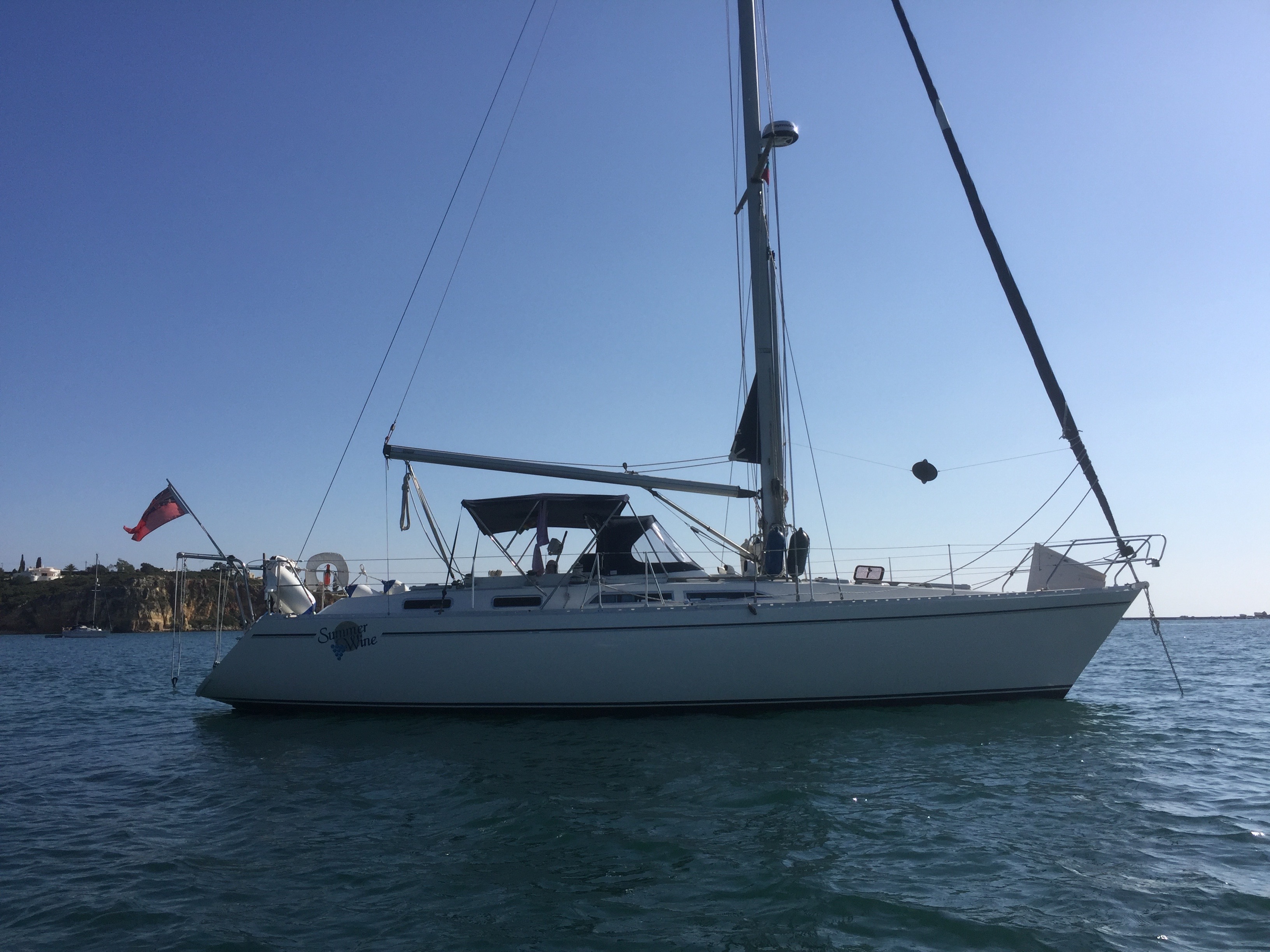

Hi Grant,

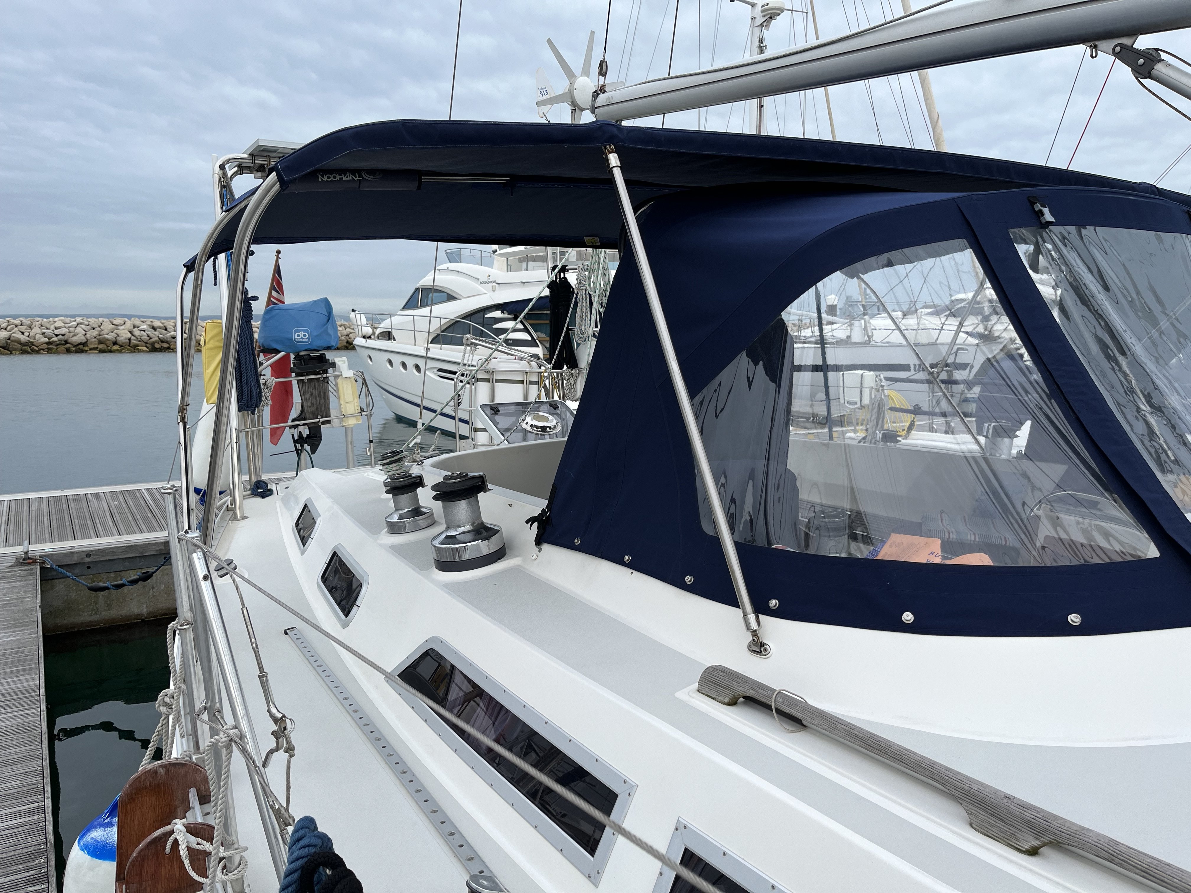

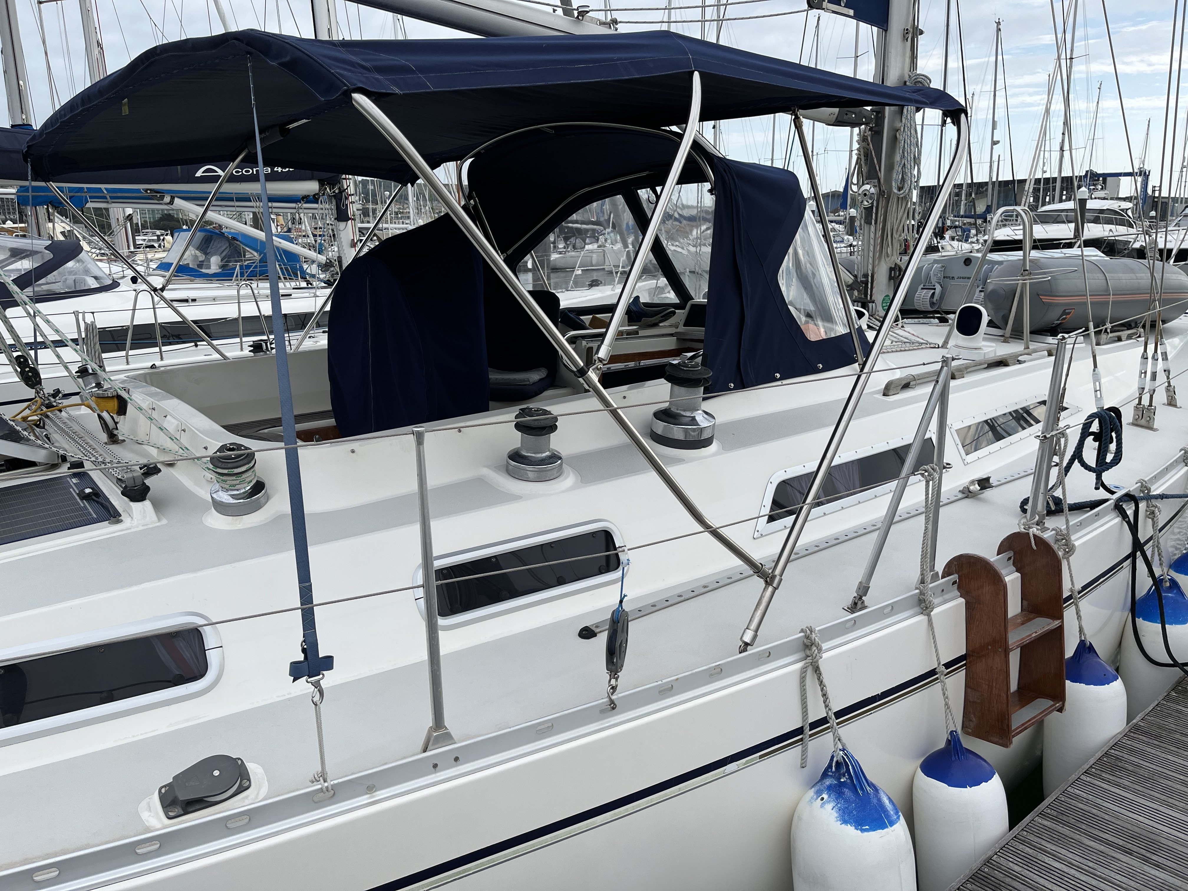

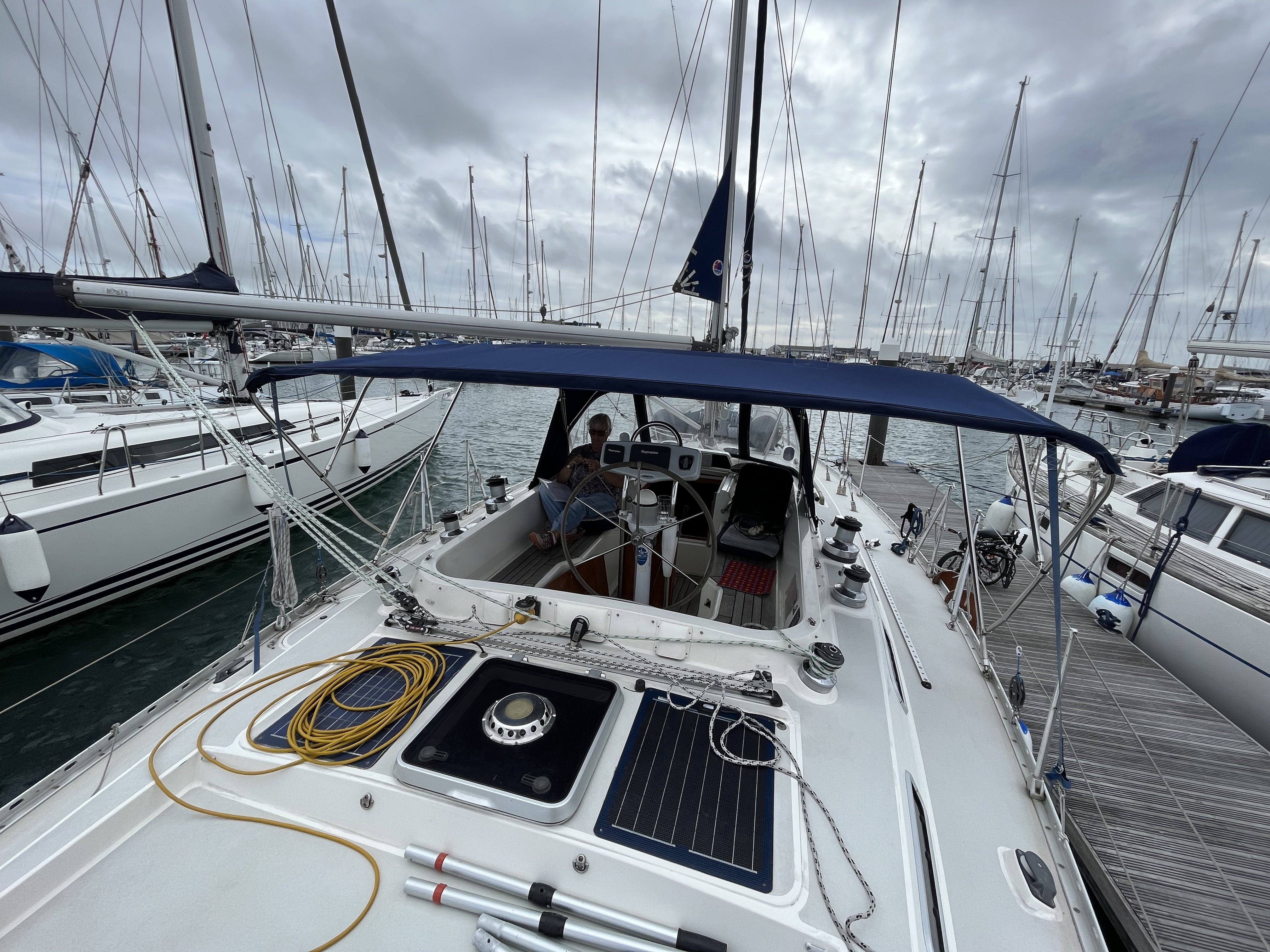

When we bought SW 7years ago it had a small cockpit side mounted bimini, that made getting in & out of the cockpit difficult (I’m 6’3” tall) and interfered with the winches, our solution was to have a toe-rail mounted bimini made;
This gives good sun/rain protection, makes getting in/out of cockpit easy and doesn’t interfere with the mainsheet, so can stay up when sailing, although I did have to move where the mainsheet attaches to the boom further back, rather than it being vertical.
These are the only photos I currently have, but can provide more next week when we’re back on SW.

Thank you guys for the response. Ian, I like the idea of side screens in port. Barry I particularly like the set up you have put together on your boat and the profile picture shows it to good effect. Its that cover whilst sailing that is critical for me and I am 6'2" so that's a great example for me. On a down wind leg does the main catch the top with it being so wide?

Hi Grant,
The mainsheet doesn’t really catch the Bimini cover/ frame when the boom is fully out/ forward for down wind sailing, as the traveller goes edges of cockpit, we’re going to the boat tomorrow, so over the weekend I’ll take some more pictures to better show the whole set up.
Rgds Barry

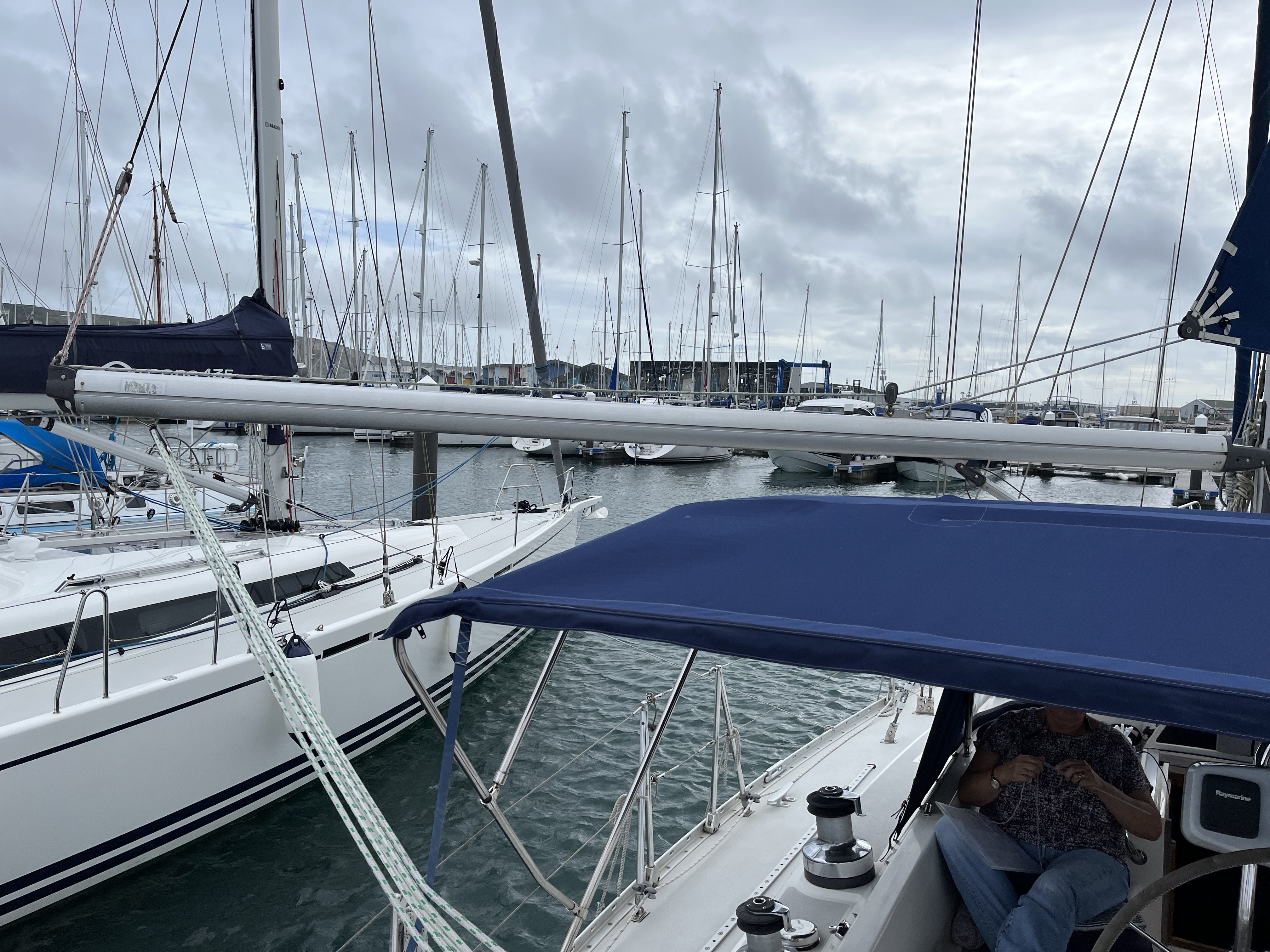

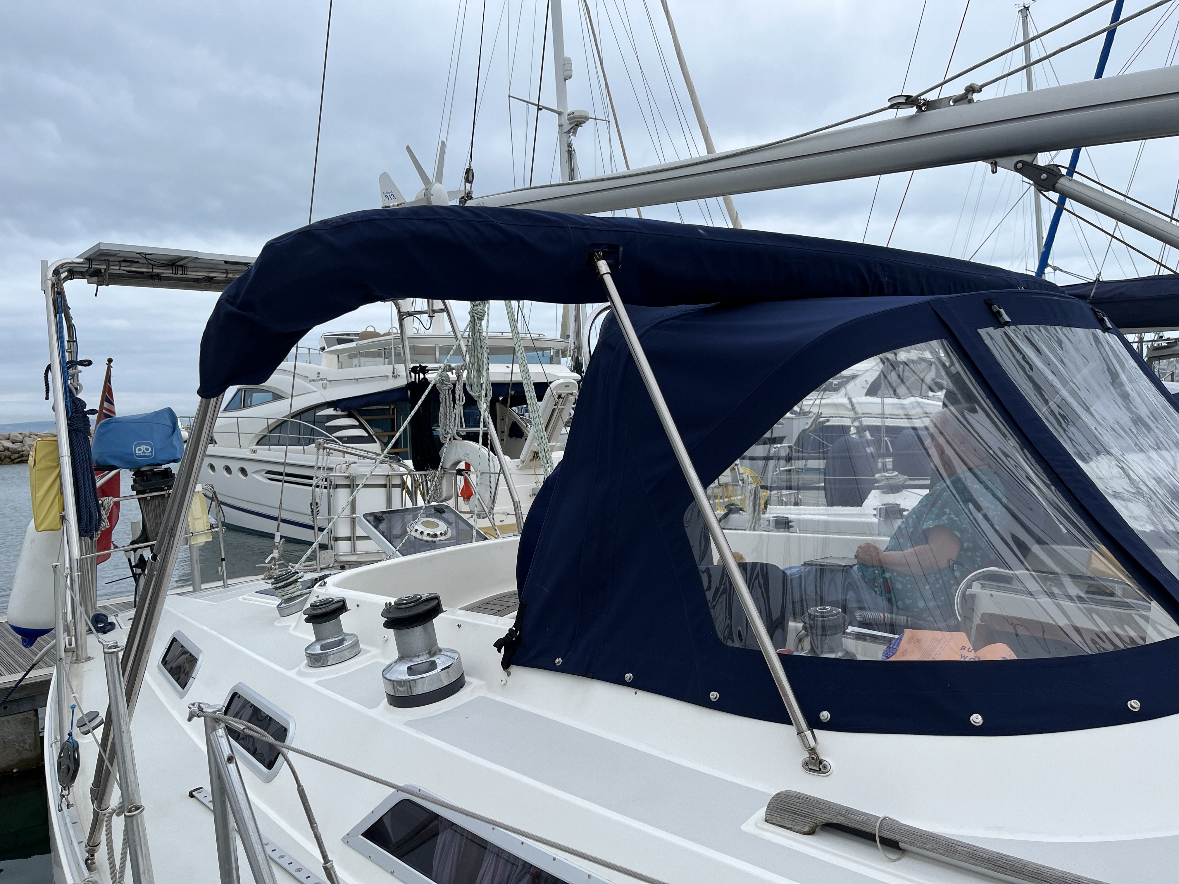

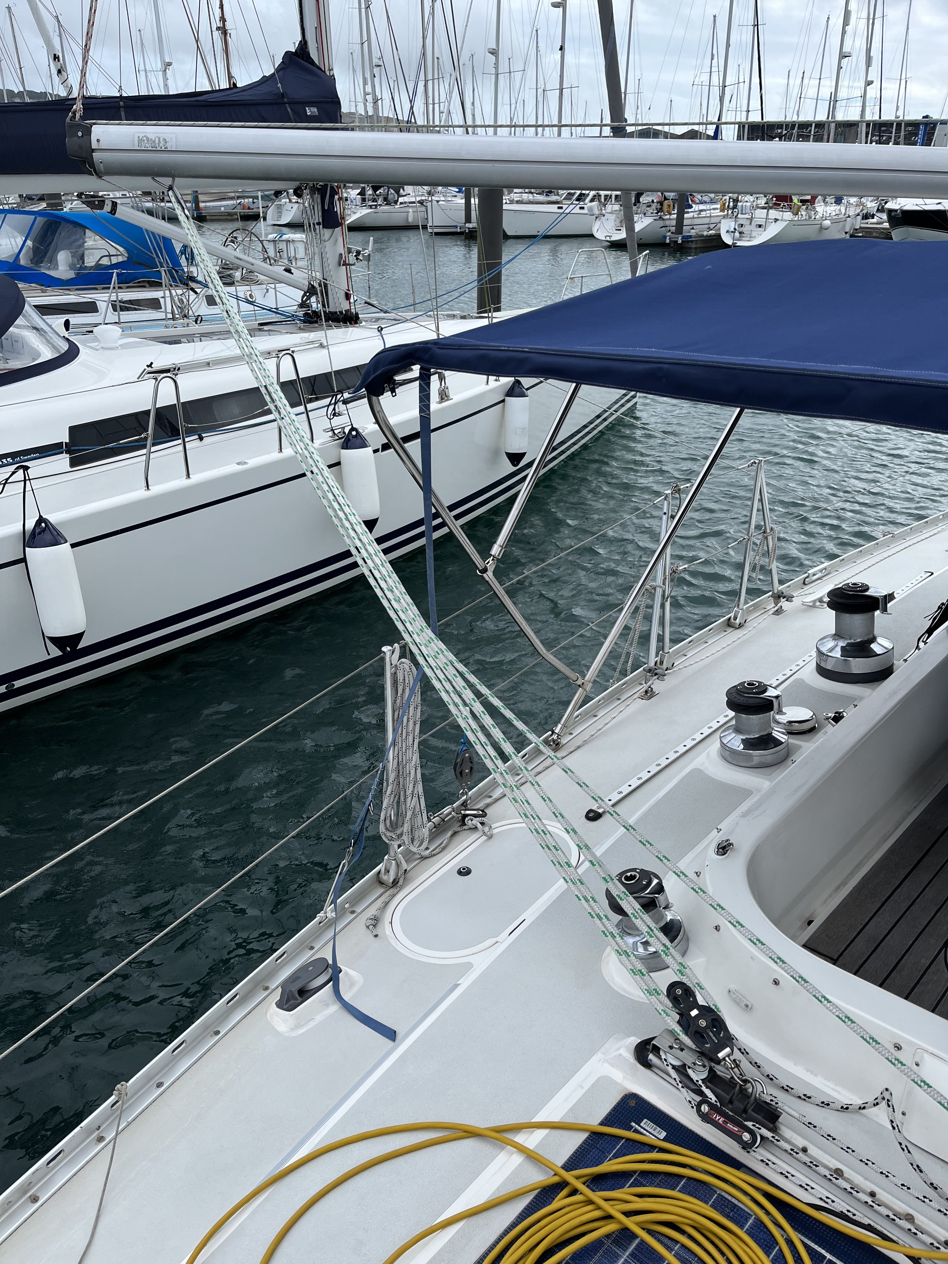

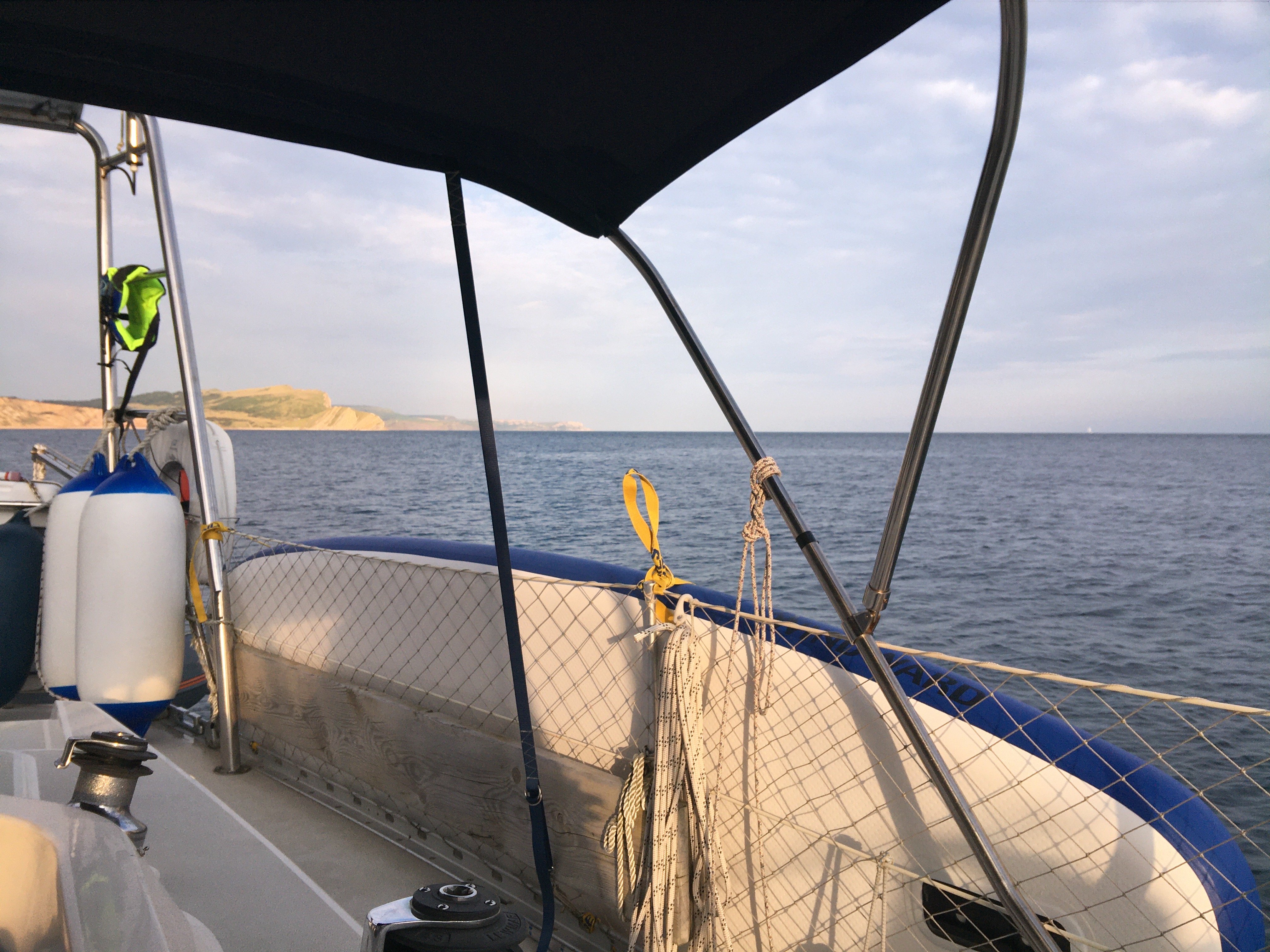

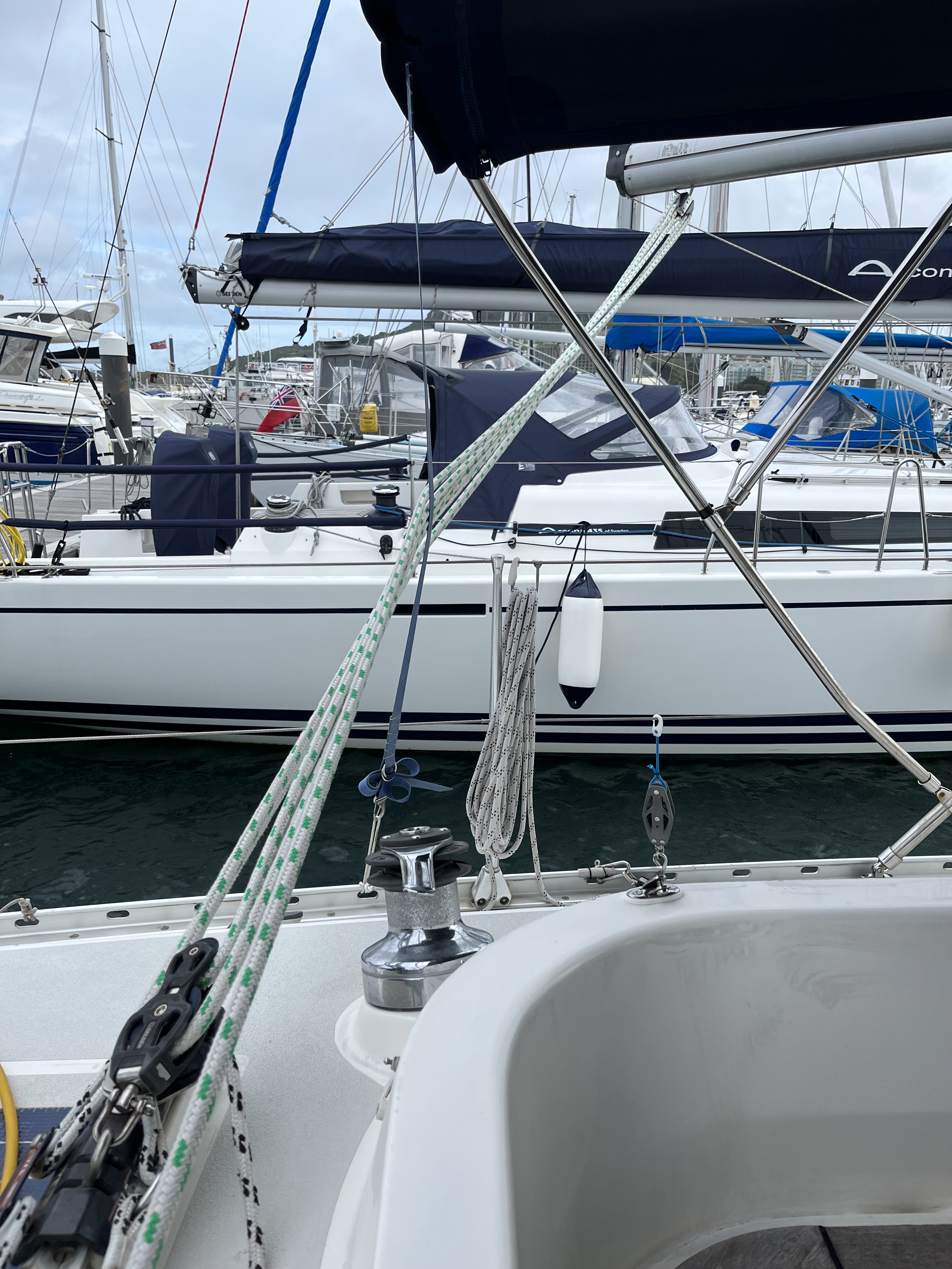

HiGrant,
As promised some more pictures of bimini …….. whilst sat in the marina, as wind far too strong to potter around sailing!
Bimini away, stores just above spray hood;
Bimini out;
I’ve then pulled the boom forward, as it would be going downwind;
It just catches the port aft bimini tensioner above, but this picture I’ve just ease the tension slightly, so mainsheet is straight;
Hope this helps?
Regards Barry

Thankyou Barry for taking the time and effort. that's exactly what I wanted to see.
It looks like very good protection unless the sun is directly to the rear at which point I could move forwards and use the pilot. My current boat with its central winch system does not allow any bimini which is fine for northern climes but we want to go south :cool:

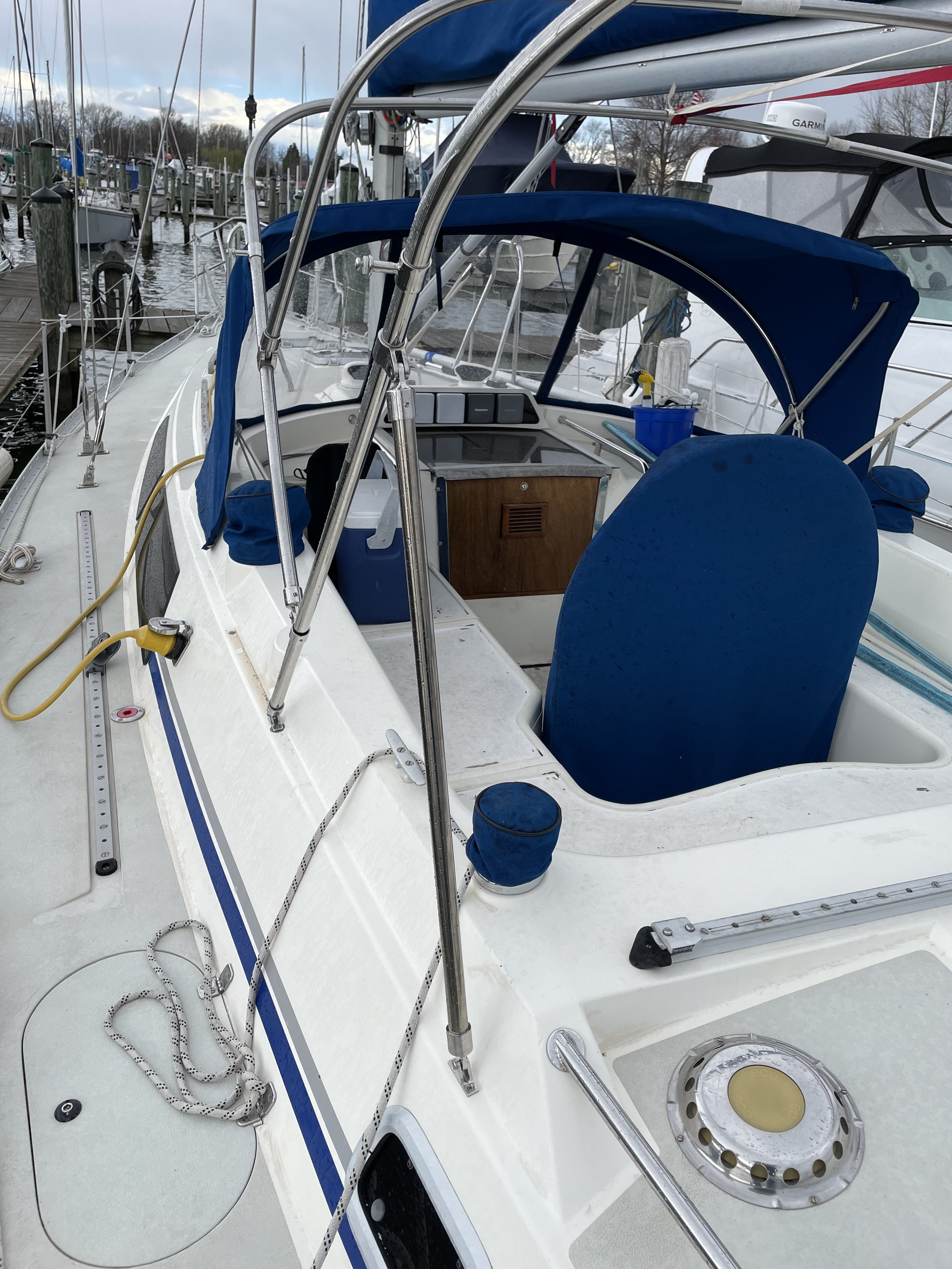

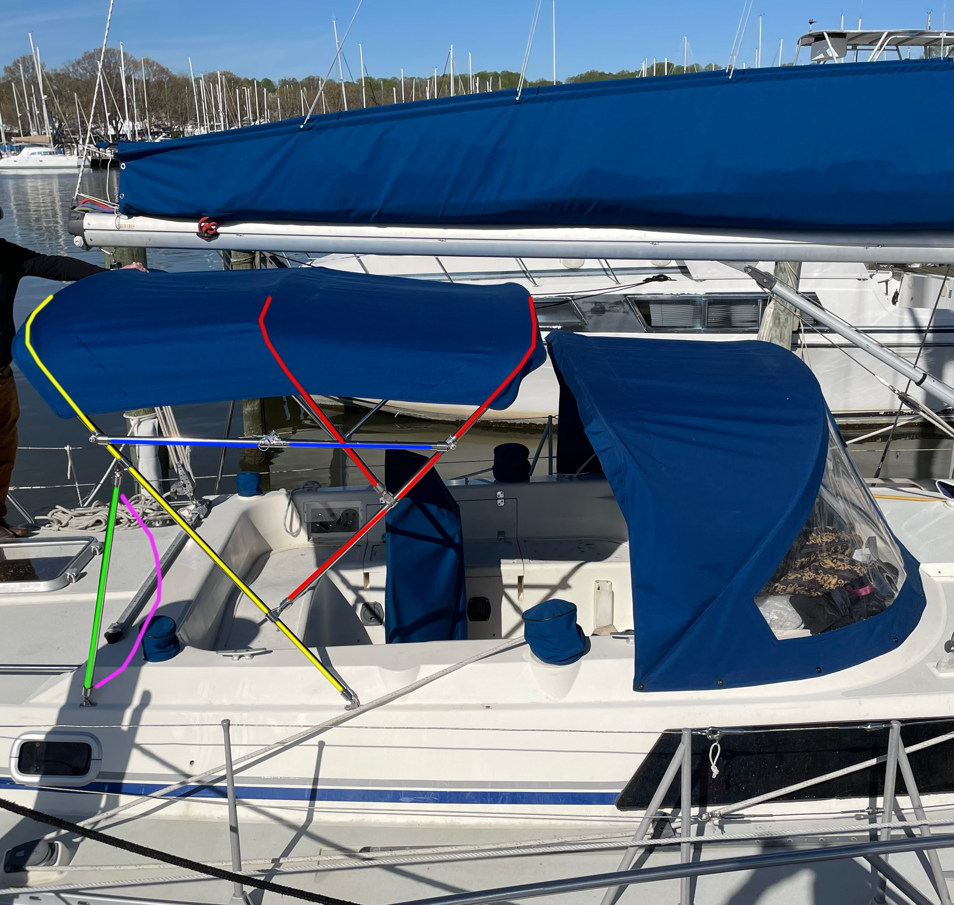

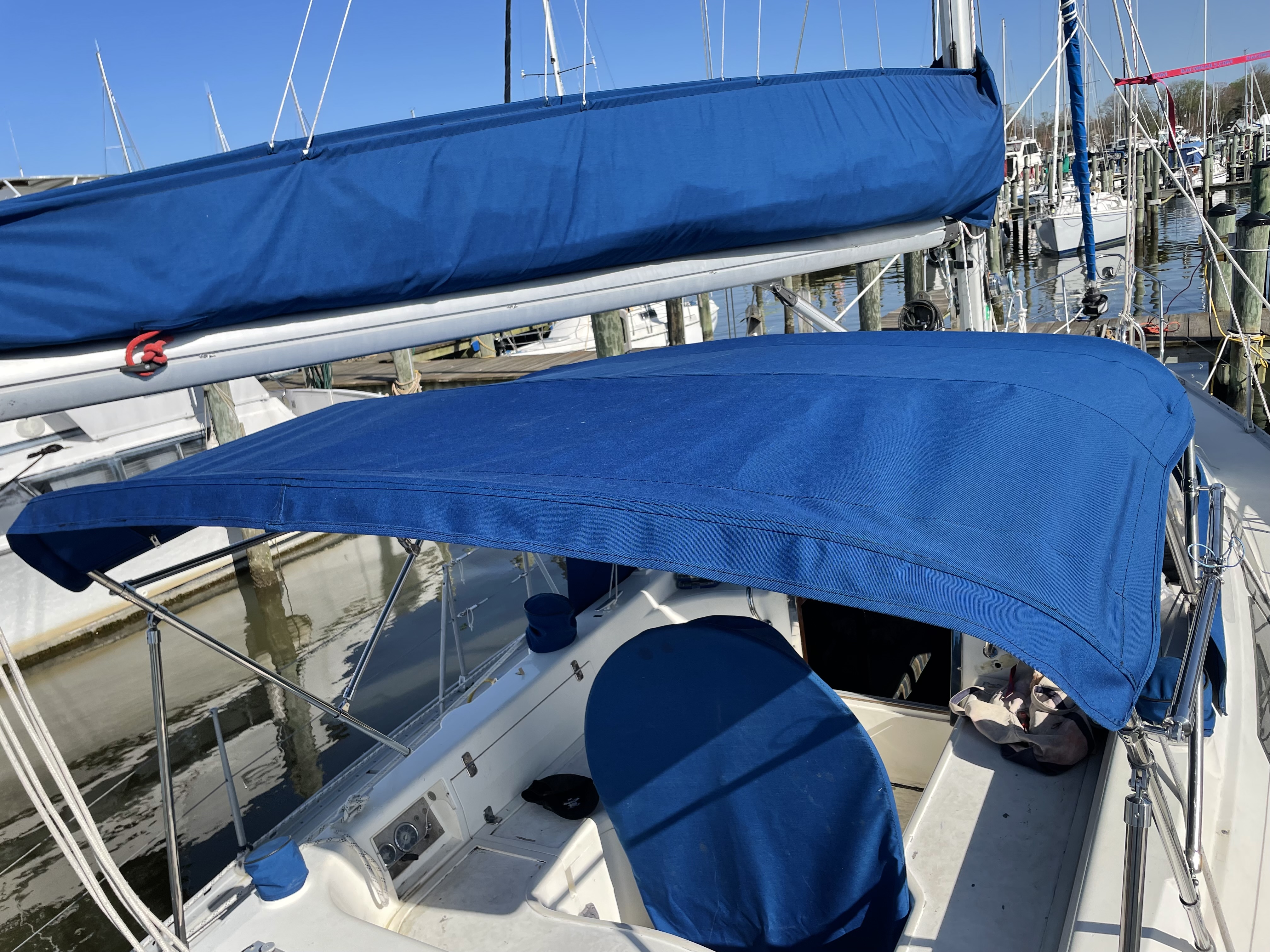

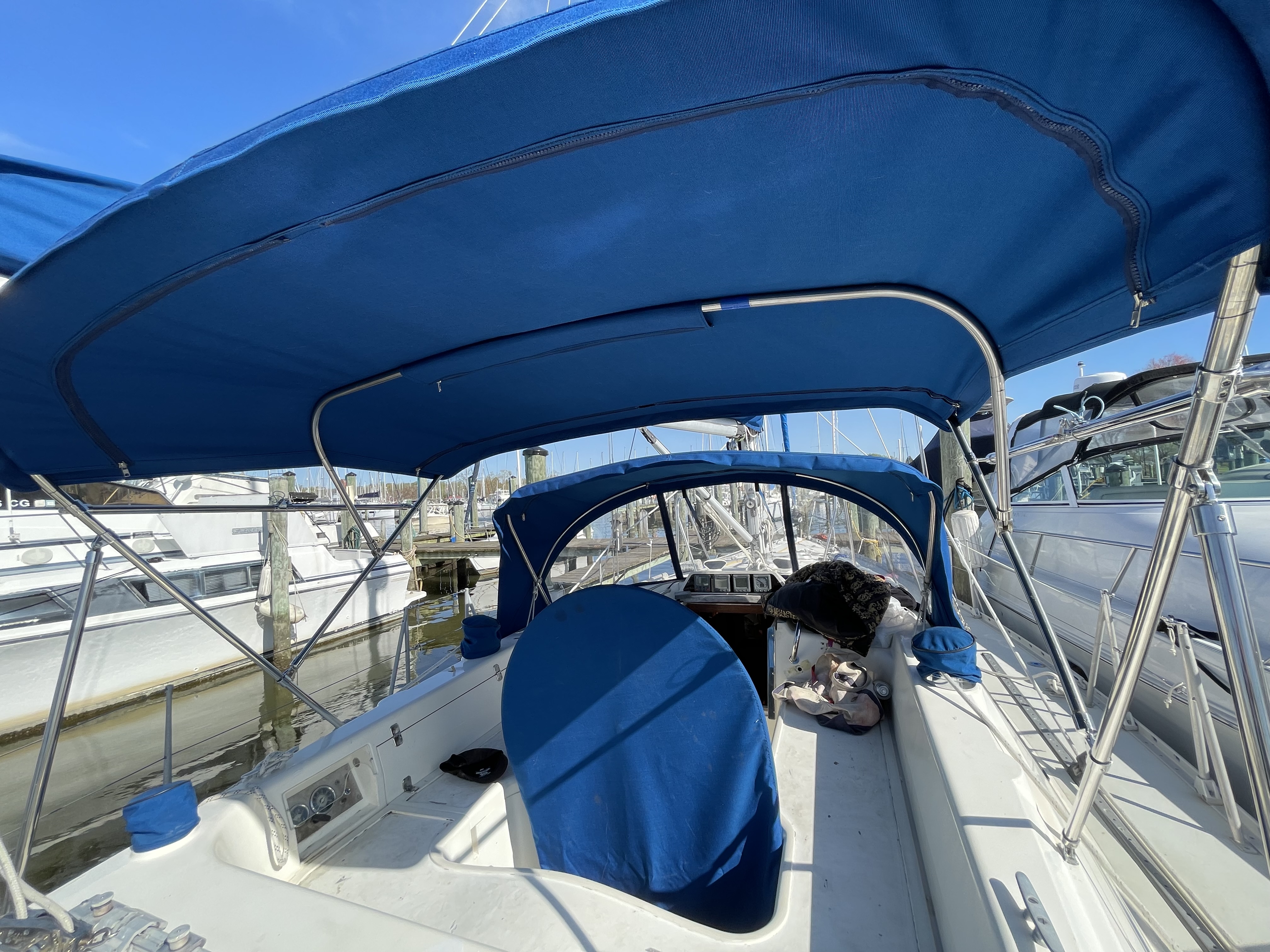

here are pics of my bimini/dodger that I build
have a friend who has a J34c he had the main sheet right in front of the helm with an adjustable backstay behind its tight but he was able to get a bimini in place. ultimately ended up attaching non flexible solar panels to the Bimini frame
down side is that he has a gap between the bimini and dodger than cant be filled while sailing. I;m sure some velcroesdpanels or zippered panels could be installed but it would add another step to tacking and such...
