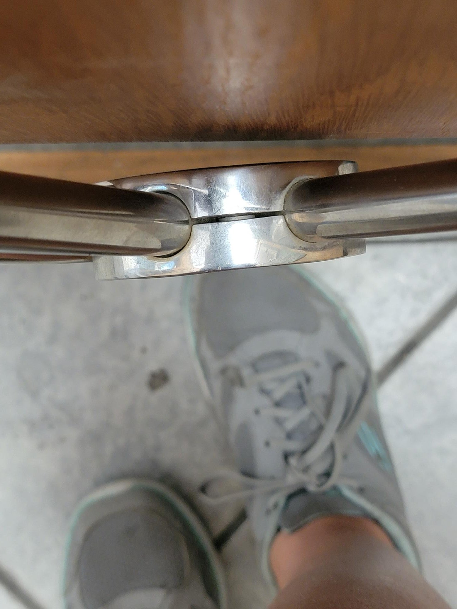

hey folks. found a wheel a stateside, but... its tweaked a bit... the outer ring of the wheel is sitting on a flat surface. so you can see the center hub is not quite right.
it is a split hub but they claim the spokes have been welded. obviously not welded properly to maintain the proper back space/dish
Is it salvagable? I could, in theory, cut/grind the welds out with a dremel and then re center and reweld to do it proper. or clamp it to something and start manhandling it to get it into shape.
Ive asked for a pic of the center hub with the top cover removed so I can see the welds. before I commit to buying.
kicker they are asking 295, on consignment. which is IMO is way too much. maybe 50-100 bucks tops... being that its crooked. If it was straight maybe 295..
any thoughts?

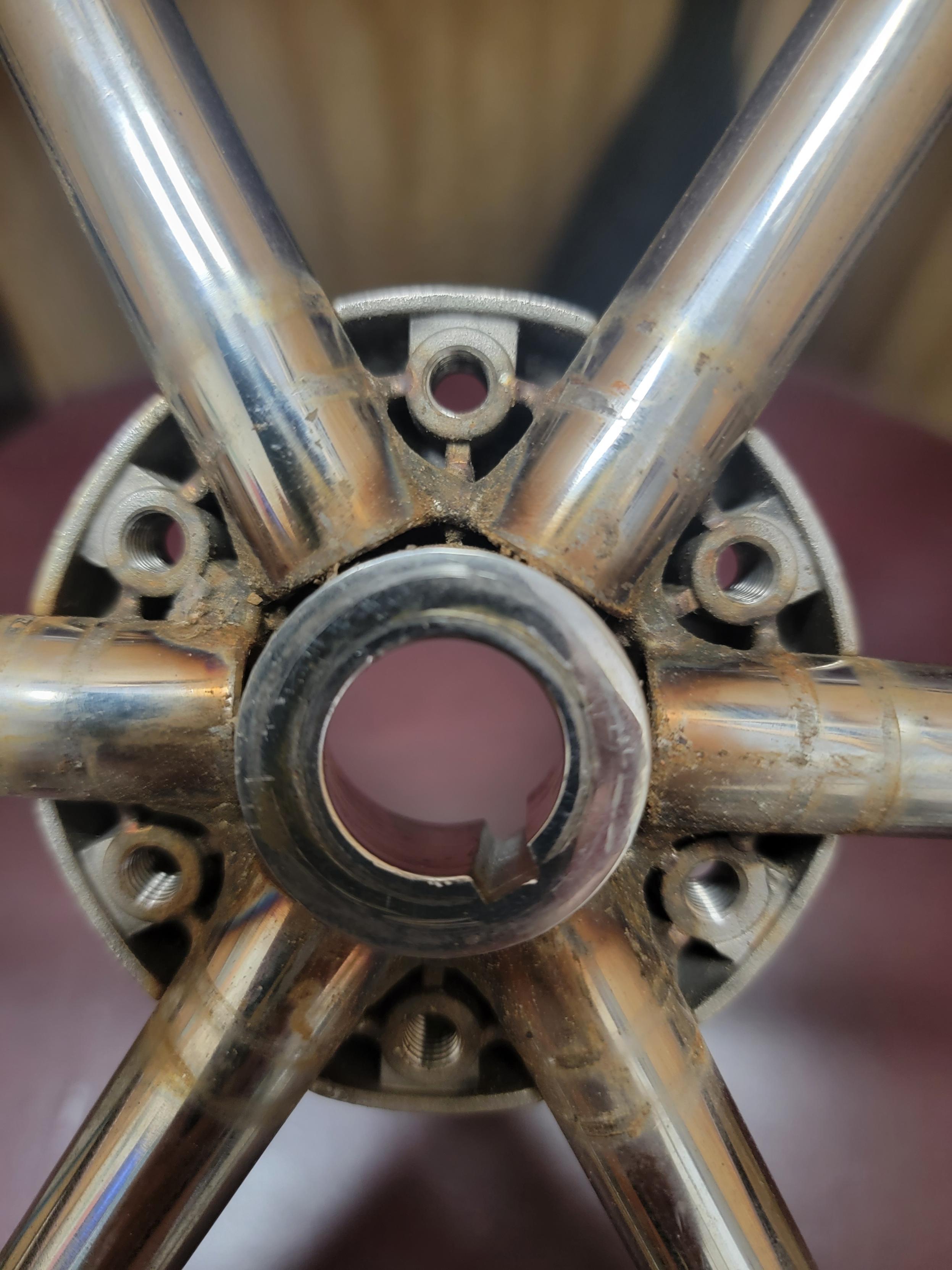

@David Ashton let me get the wheel in my hand and put eyes on in person. here is a photo with the hub cover plate removed.
Ok
In a nut shell the holes in the hub were too big so the hub didn't clamp the spokes allowing the spokes to move slightly and this broke the tack welds
Dave
so heat to soften and then bend or grinding and reweld
