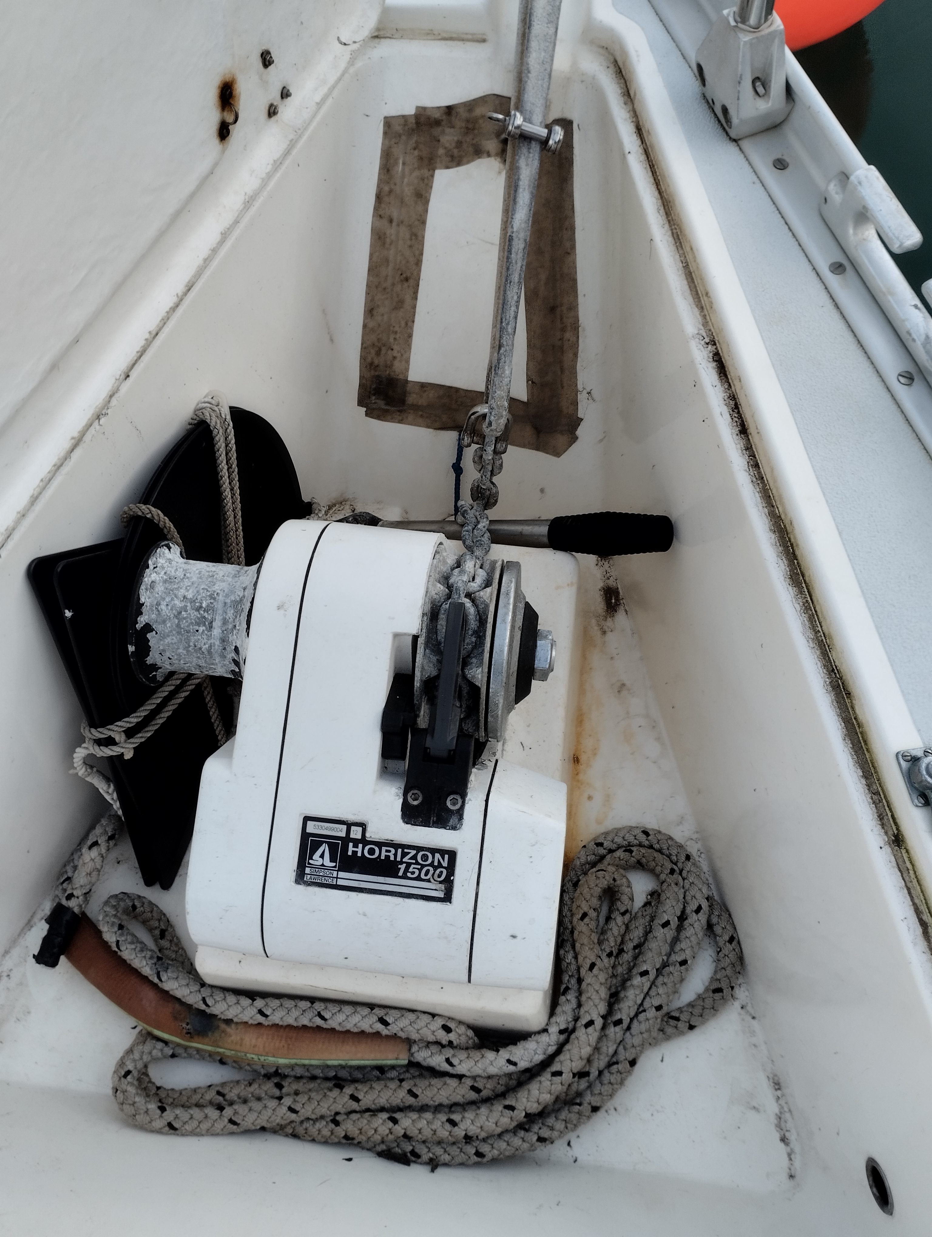

Hi Bob
Not sure I should use this thread, and I truly hope you did find the the parts you were looking for....
Could you tell me the exact chain size you use in your horizon 1500?
I happen to have the same windlass but am not sure about chain size...and my chain needs to be changed. Also I am not sure every horizon 1500 uses the same chain size.

Hi Ilbon,
No problem, my windlass was fitted with an 8mm gypsy as my old chain was 8mm. I have upgraded to 10 mm chain and a 25k Rocna. All this involved was changing the gypsy, which was a fairly easy 10 minute job. The hard part was locating the10mm gypsy, another member kindly sold me his old windless..
Looking at your photo I would say yours is 8mm, easily checked with a vernier across the link width.

Hi Bob
thanks for your explanation, it does help.
Now you got me thinking...shall I upgrade mine to a 10mm, too? But then I realised your boat is an M42 while mine is an M35, hence a 10mm chain may be well oversized for my M35. On the other hand I will upgrade to a 20kg Rocna from my actual 15kg one, which I will use as a spare. Any comment on this will be appreciated.
I may take off the gypsy for greasing/maintenance, maybe there is some tag where the size is indicated. I will follow this "cheating note" for the measurements
