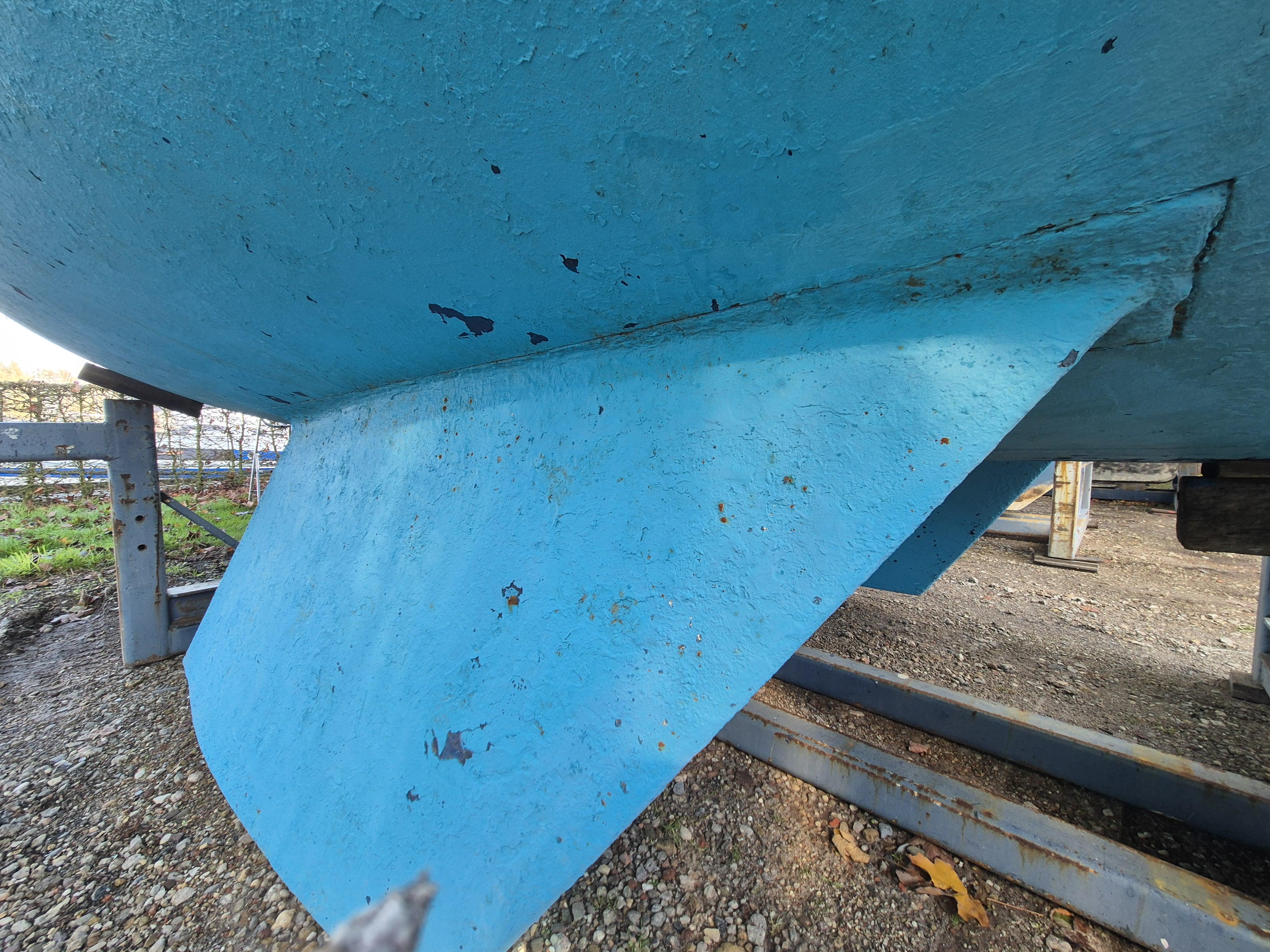

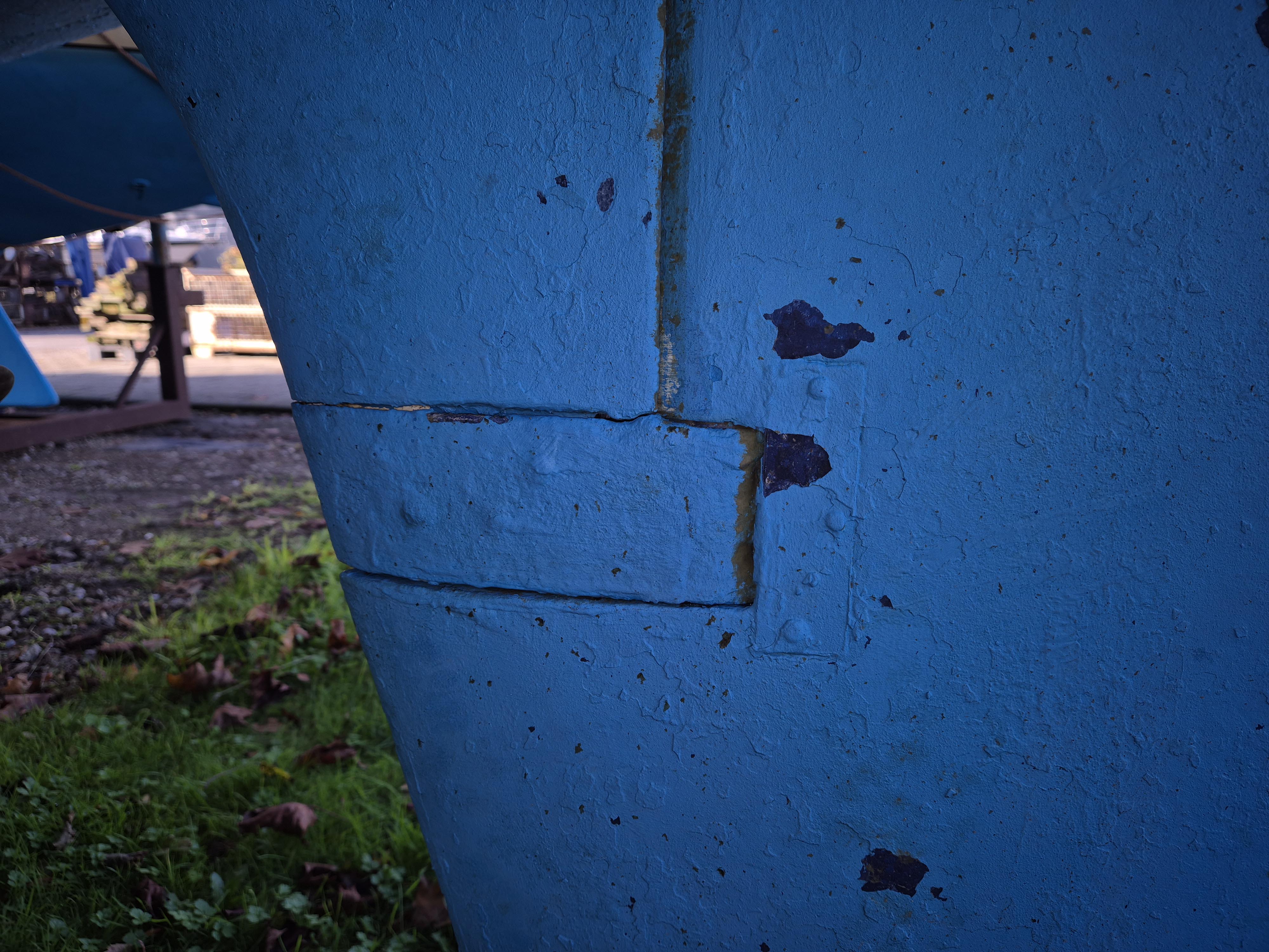

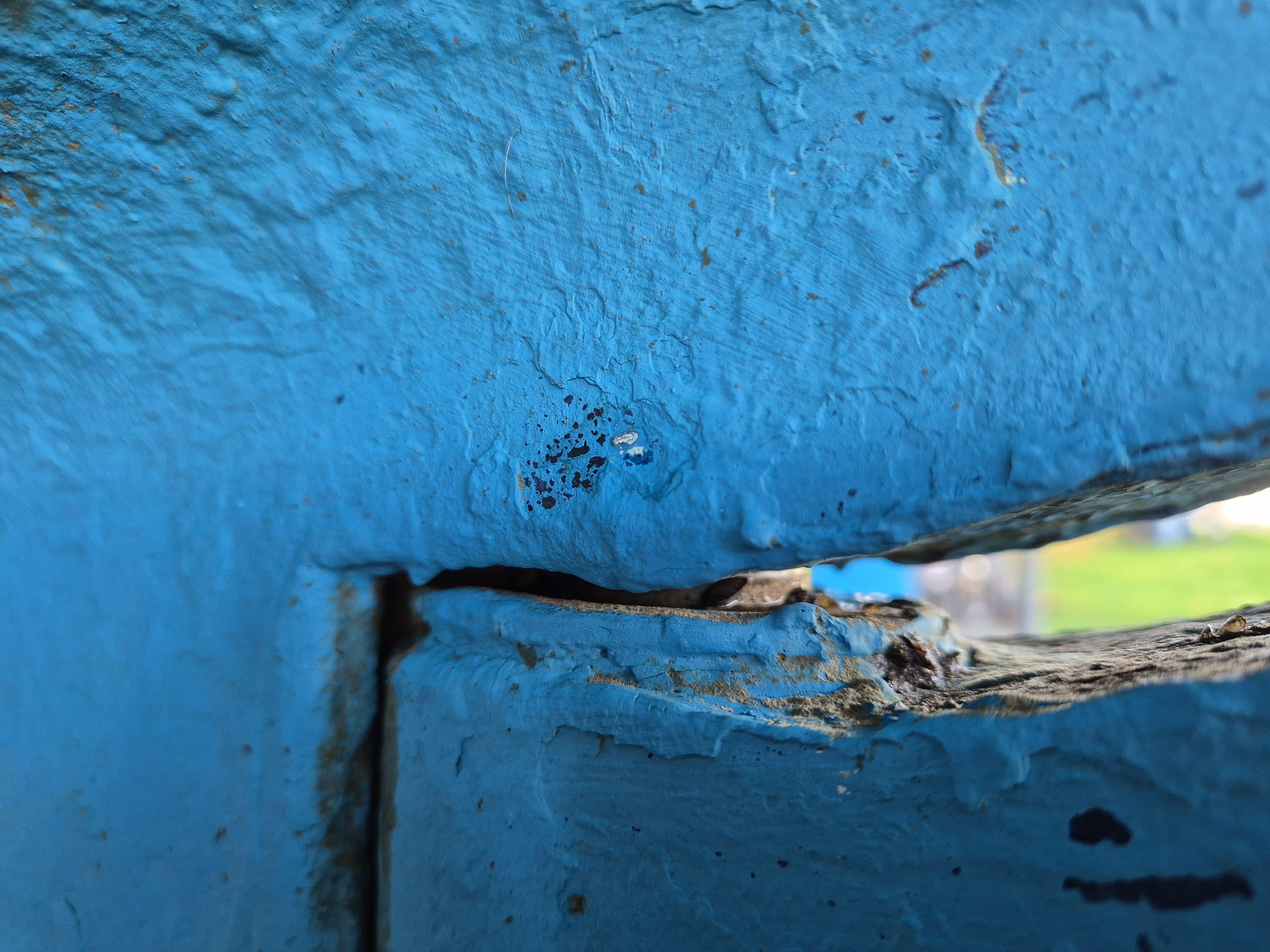

Rudder shoe has a some play on the skeg. As I learned it is made of cast bronze and fixed with copper rivets.
I think it will have to be completely reseated and fixed properly. Grind of heads and hammer out? Reseat with epoxy or something flexible? Fix with copper rivets again or is there something better / easier?

The rudder shoe should be fitted back with a sealant. Copper rivets again would be best but some people use stainless steel bolts and nuts.
