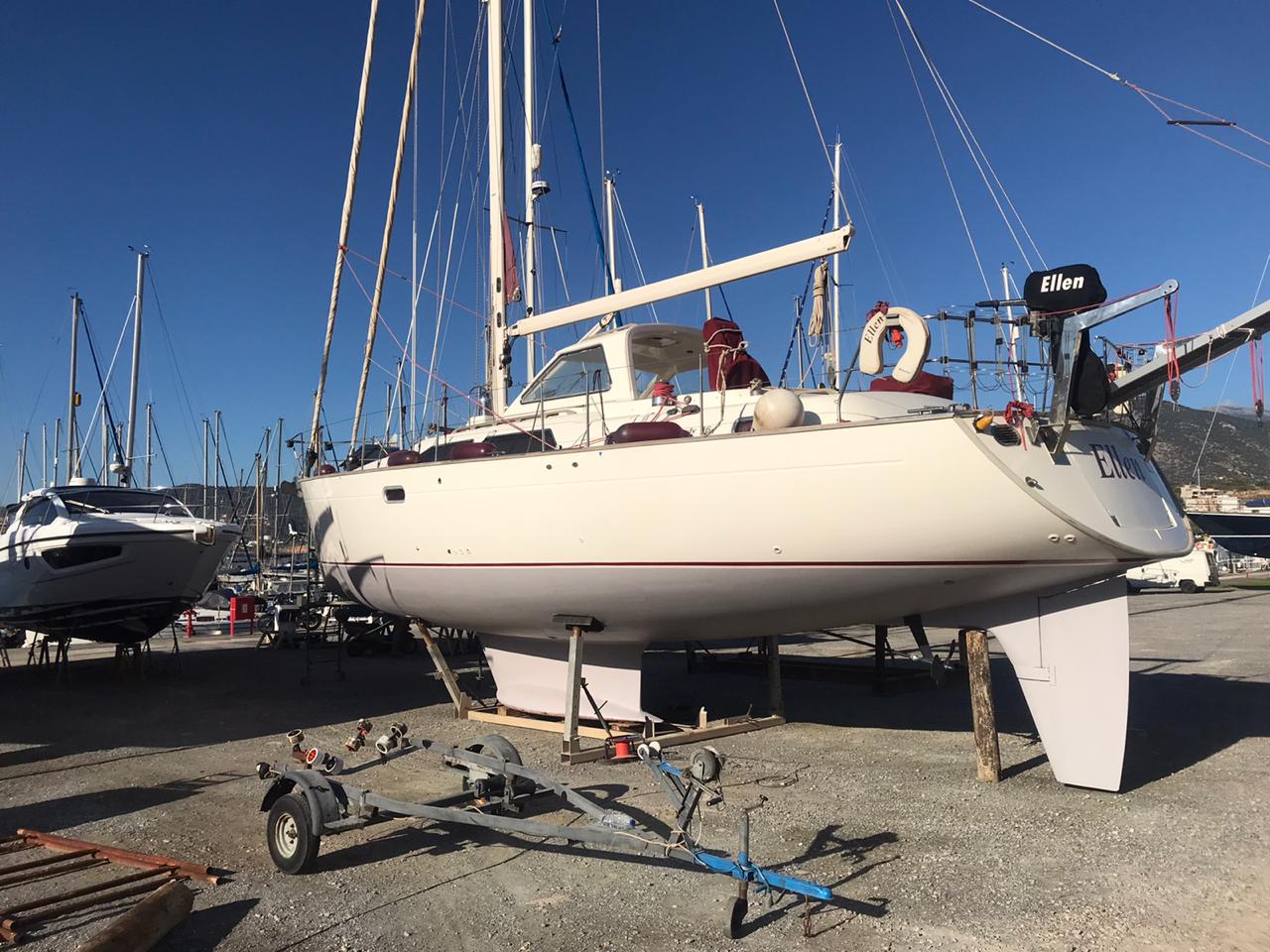

I am about to buy a used Moody 46 and I would like to get the dimensions of the sails so I can replace. They are all furling so am considering triradials but need the dimensions to get quotes
