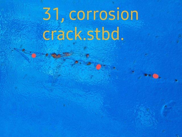

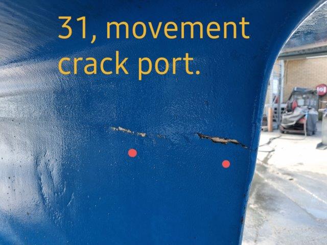

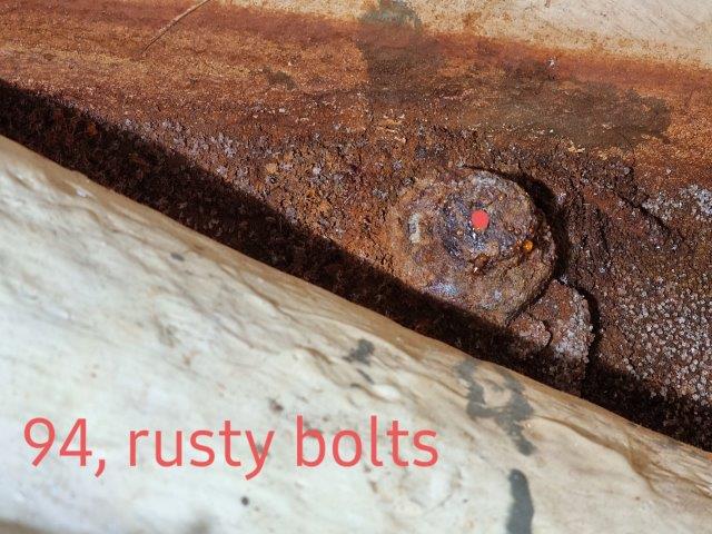

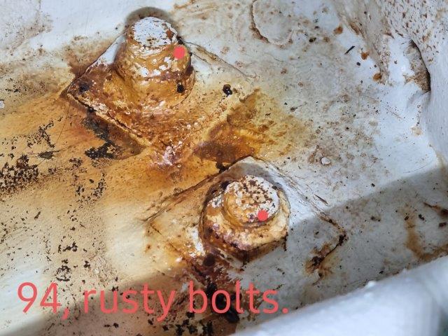

I have just had the results of a survey on the Moody 43 Eclipse I have an offer on and it has come back with a few minor issues which I was already aware off however the keel shows cracking in the antifoul on the keel/hull join which the surveyor says is a movement crack. There is some minor corrosion on the top of most keel bolts but one in particular is badly rusted (picture). Is this a cause for major concern i.e. drop the keel and replace all bolts or is it to be expected on a 1991 boat and should just be monitored? Thanks to everyone for your assistance.

In my personal view, from the photos you have provided, this boat does not have a significant problem. The reason that keel to hull joints are made with a material that dries to a hardish rubber like consistency is that the joint inevitably moves when sailed hard. The exterior cracking, both from corrosion and movement will easily clean up and repaint. The rust ones are in my view, the slightly more concerning - if not attended to, over years the rust can migrate across the top face of the keel to the keel studs, then start them corroding, at which point the only cure is to drop the keel and remake the joint. With the minor rusting shown in your photos, I would grind out the rust as far as practical, repaint any exposed iron with a rust and moisture tolerant epoxy primer replace any joint material lost with Sika 292i or 3M 5200, then replace the antifoul. For the movement cracks, remove any flaked off antifoul and repaint.
The condition of the stud tops and nuts is remarkably good, bearing in mind that the studs nuts and backing plates are all carbon steel. Marine Projects, who built these boats, avoided stainless steel because of concerns about crevice corrosion. Some corrosion is almost inevitable as salt water gets into the bilge, e.g. when cleaning the log transducer. If their appearance offends you, you could clean them with a wire brush and paint them with a tough, rust tolerant finish such as Hammerite.
Many members have drawn a stud for inspection and they invariably find that the stud below the backing plate is in perfect condition

My opinion of the significance of your surveyor's findings is of limited value as it is based entirely on a few photos and I am not a professional marine surveyor.

If you chip off the flow coat and clean up the nuts with a wire brush, you will be surprised how good most of them look. Rust occupies about 8 times the volume that the steel it came from did, so you get an awful lot of rust for very little loss of steel. Even the one in your first photo will clean up remarkably well.
The flowcoat was not a good idea for painting the nuts, studs and backing plate - I guess they used it because they were painting the bilge with it anyway. Hence my advice in post#2 above, but Paul seems to have an alternative approach.
