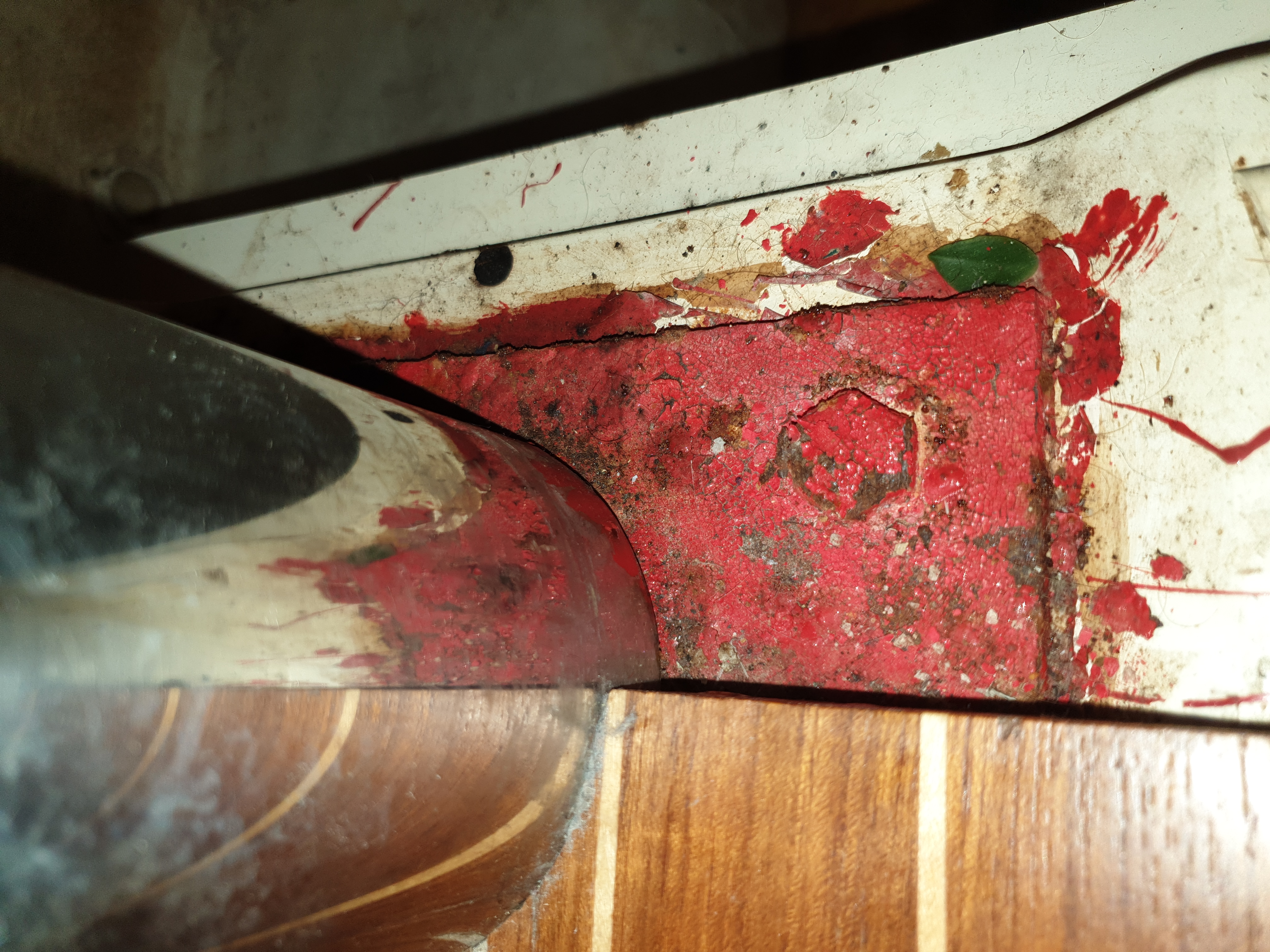

May I ask what is meant with mast compression post corrosion? (sorry for the silly questions ;)
Is it something like this:
Independently, is this on the picture a common issue of a M38 and is it something to worry?
Kr, Damir
Yes that’s the base of the post.
Some are mild steel and corrode at the base.
That looks in good condition and polished St Steel. (Or Chromed steel)
Check for any hairline cracks in the fibre glass base area.
There is normally a large hardwood block under this gel coated area - and if it has been wet for a long time - it rots and the post (which takes the rig load) compresses it and the glass fibre cracks.
