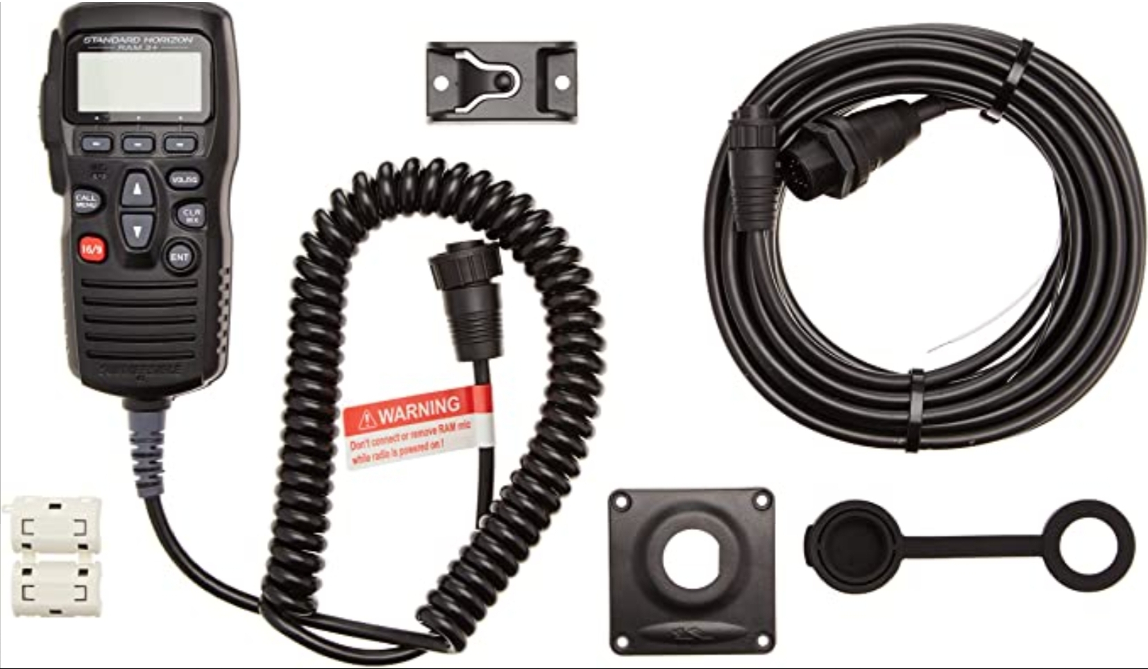

I'm looking for the panel mount connection that goes between the extension cable from a Standard Horizon GX 1500 and the remote mike RAM +. I've tried Standard a couple of times, but no reply. Anyone changed radios recently ?

The panel mount for the Eclipse GX1500 is made up of three parts. There is the cable with the larger socket on the end, a faceplate and a rubber cap.
Search the internet for S8101512 and you will find the cable part at a few suppliers

Picture of all the parts below for example (ignoring the actual RAM model)

Thank you both for your suggestions. Looking at the Seamark sit there are two cables for this job. Unfortunately Cactus have sent me the wrong one despite assuring me after a query that this was the only one. I'm getting there quietly !
Update. Contacted Cactus, they are replacing the cable for the correct one.
Thanks again.
Clive.
One cable is the extension cable and the other is the one that makes up the panel mount socket. It's the latter that is included with the actual RAM kit.
