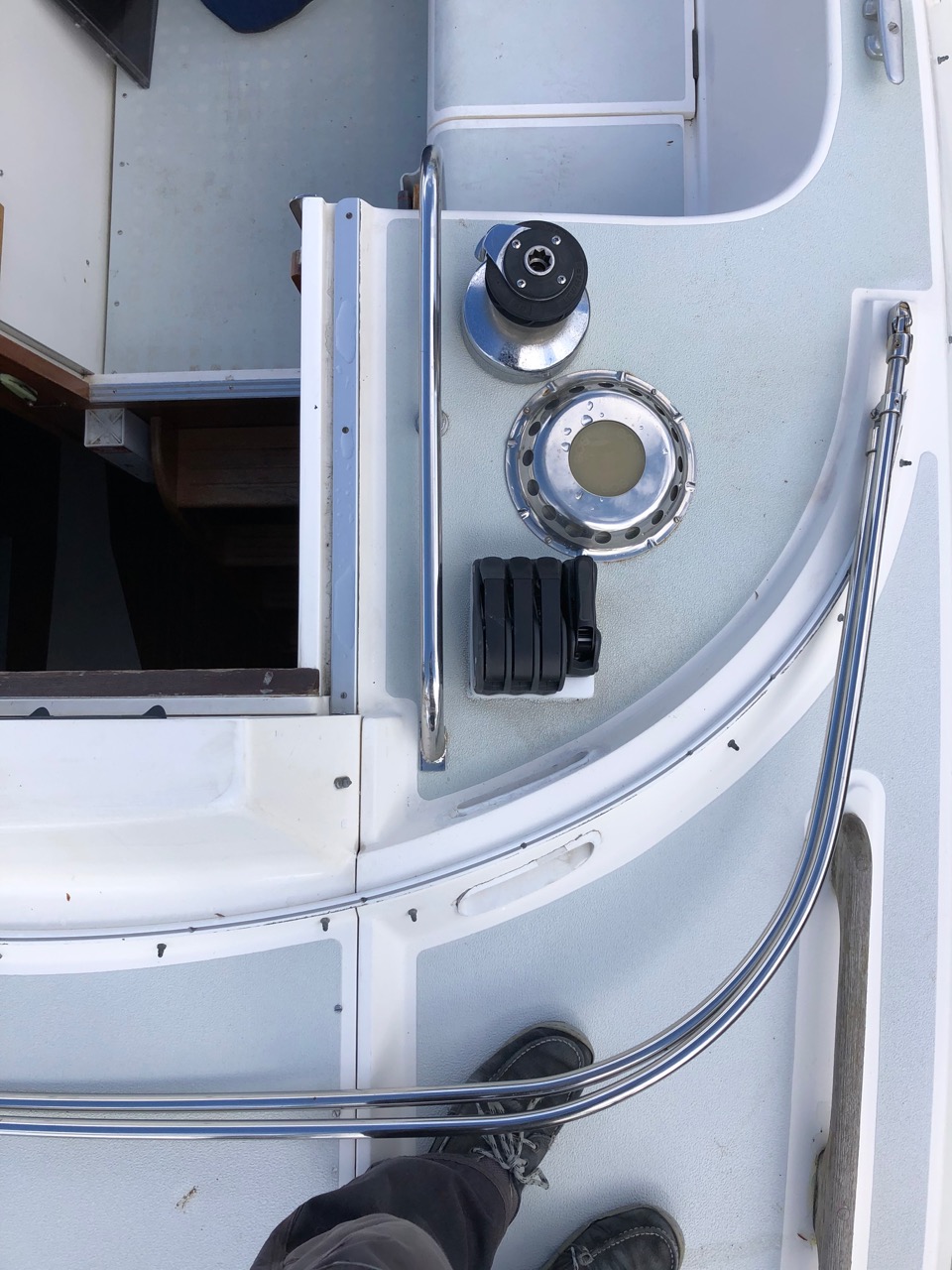

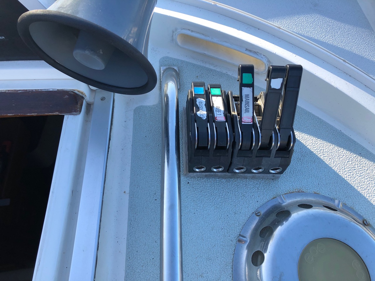

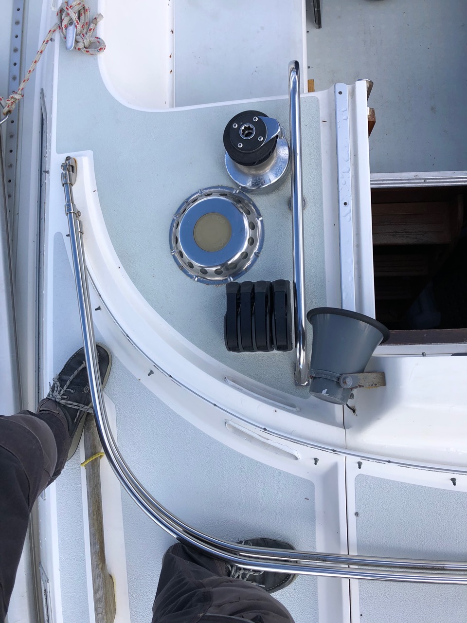

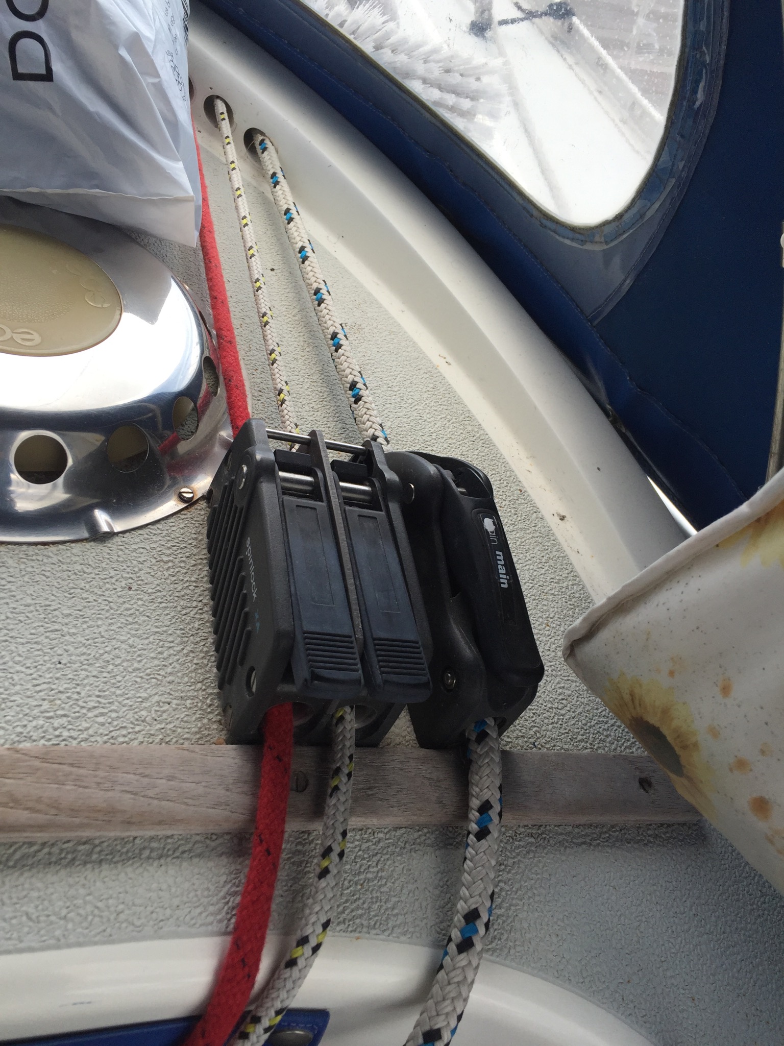

For me, a prev owner had made the mod already but I recently upgraded the clutches as those fitted were too small and did not allow the lines to run freely. The pic shows the original setup (Port side had 4 of same type) and also shows the hole through the coaming which is hollow so no worries about drilling thru it. Other owners have separate holes for each line rather than the big slot I have (which is not finished that well - its on the list of cosmetic tidy-up jobs which always seem to drift...)
I went with Spinliock replacements and having lived with the annoyance of too small clutches I upgraded to the XTS model rather than XAS - I just preferred the solid ergonomics of the XTS and the higher load rating. It does restrict the number available so just work out how many you want and measure carefully before deciding - I actually ended up fitting 7 XTS and 1 XAS!

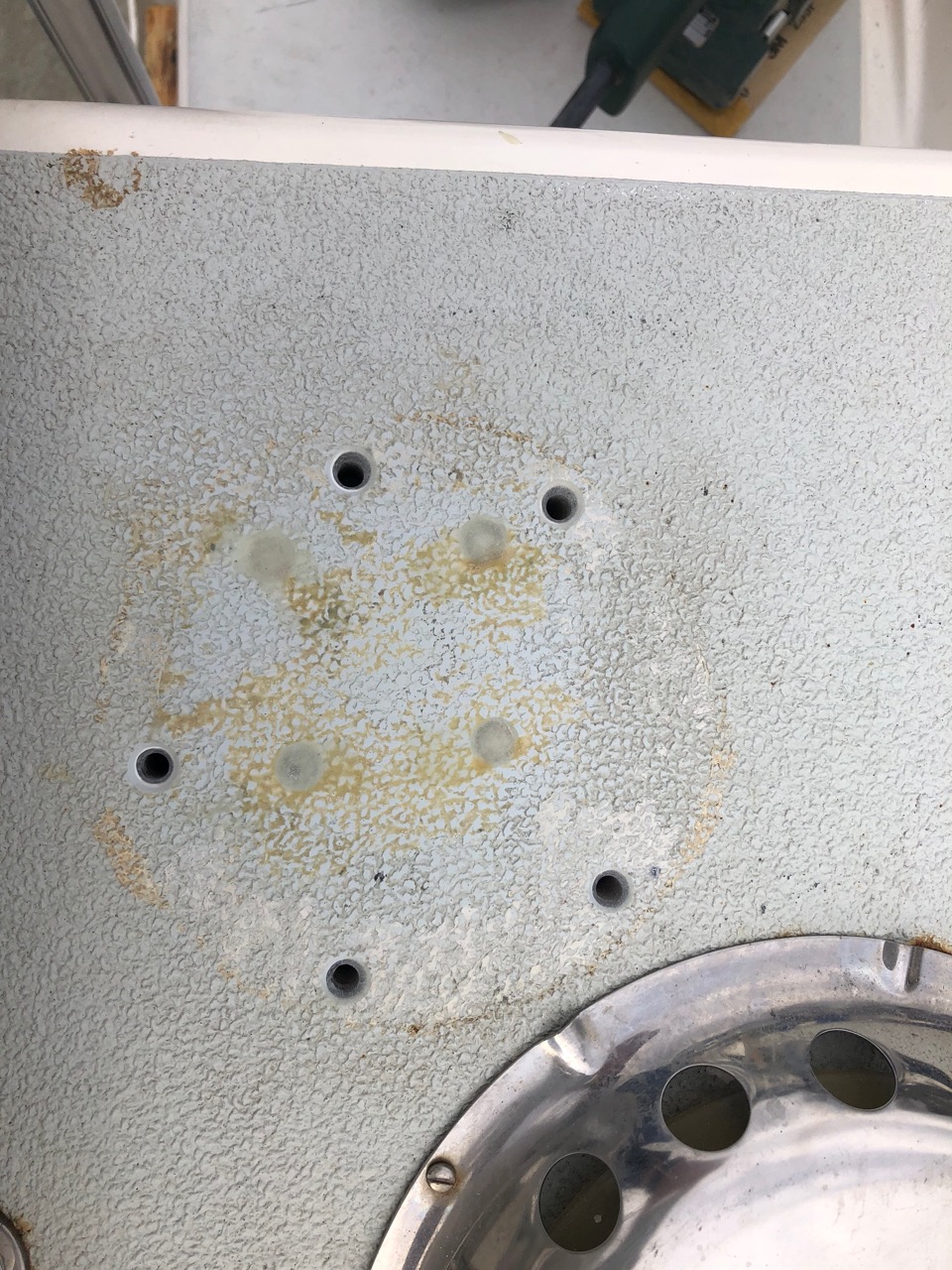

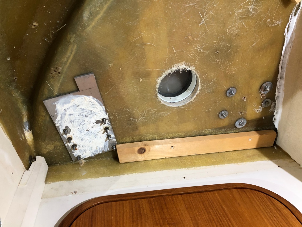

The winches I already had (Lewmar 40ST) were absolutely fine but when I removed the headlining I discovered they'd been fitted without backing plates and old holes from even older winches had not been filled properly to protect to the balsa core and I therefore ended up removing and refitting them too.

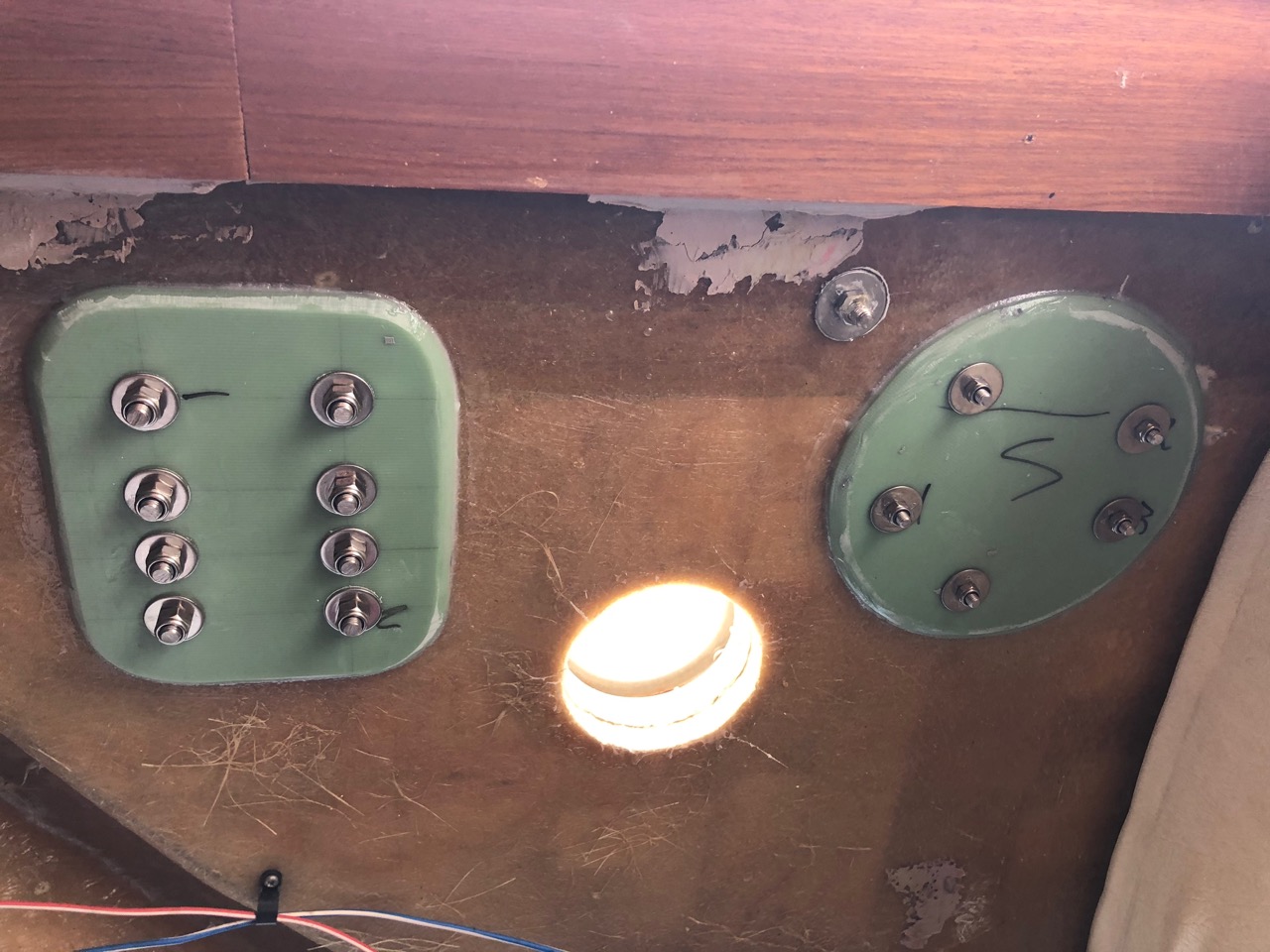

The pic shows the original arrangement in the heads - a thin scrap piece of aluminium as backing plate on the clutches and none for the winch. There was no sign anywhere of fractures/damage to the grp in the coachroof even with this arrangement which demonstrates the strength of the original build. Your choice of backing plates will be personal preference - I opted for 6mm G10 fixed in place with thickened epoxy. On the port side the heads door frame actually impinges on the ideal clutch location. You could chop some out as Robert did or just work round it. My initial setup with less clutches on the port side was because of this and as I wanted to cover all trace of the original fit with the new ones, I just followed suit and avoided disturbing the heads doorway. The 1st pic shows how the same area looked after my upgrade, and the 2nd is the stb side where there are no space restrictions.

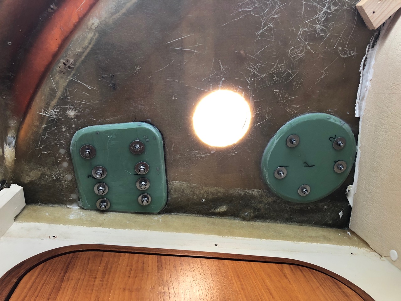

The area is balsa cored so care is needed with drilling and filling holes. I opted for the method of drilling out bolt diameter holes (8mm) and then using a dremel with a router bit to clear out more of the balsa between the skins to create an approx 16mm diameter void. This was all then filled with thickened epoxy before redrilling the bolt holes and bevelling them to improve sealing (I used butyl tape to bed everything). The pics show the finished prep for one of the winches with the old holes also now properly filled with epoxy and the finished install on both sides.
I used 10mm acetal as a riser block for the clutches to line up with the coaming and give the correct lead angles to the winches and also clear the vents. Once you select hardware you'll need to work out what height of riser you need and the positioning of the winches to get the angles needed.
View attachment 23168View attachment 23169
View attachment 23170View attachment 23172View attachment 23171

Hi Peter, As you can see from below photo - my boat had 3 pipes fitted thru the coaming back to the clutches. however you can only just make out on this photo, they dont line up properly from the deck organiser or the clutches. This causes huge friction under load and has led to a leak on the fwd side of the ducts where they meet the deck.
I was looking to either have a fibre glass fella come and change it to look like hte later M346's or cur an oval like yours.
My Question - did you - or does anyone know - where to get that lovely oval duct? It would enable me to solve the leak, reduce the friction and not have to move the clutches and organiser on the deck!

Hi Neil - I'm afraid it was a previous owner who did the work so I don't know where he sourced the ducting. I do not believe its GRP though - it feels more like a UPVC type material and that would explain the way the external finish of filler/gelcoat has cracked away from it. Internally it is fixed with a marine adhesive/sealant so it does not leak but it doesn't look pretty. As I say, its on my list to try to improve... maybe this winter!
