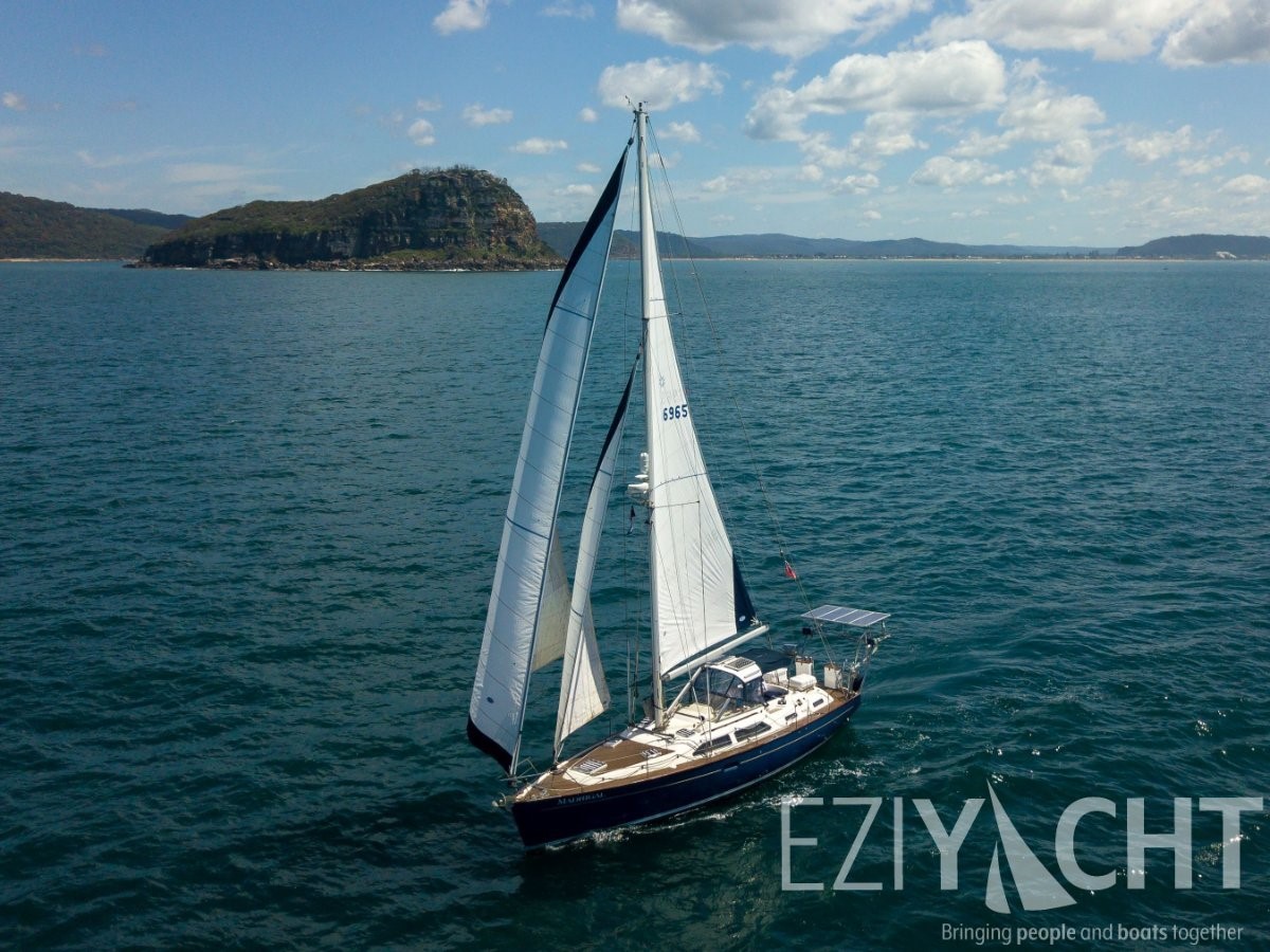

Gracias Peter, (or obrigado as I am Portuguese ) for yet another educational insight on nautical terminology. In the attached picture you can see Madrigal's in all her glory. A great set up offering many options for different wind conditions. Really hoping a typical southern ocean storm is not one of them any time soon.....
Feliz Natal/Merry Christmas
Miguel

Hi Miguel,
I'm sorry I guessed your nationality wrong, I'm afraid I don't speak much Portuguese. n joining the MOA, you will find other members who sail in Portuguese waters.
I trust your purchase will complete quickly so you can get to know your new yacht soon, she looks beautiful in the photo. I must ay, itlooks to me rather as if she has a full genoa set together wit the staysail which, in my experience, is unusual. I wonder what other M46 owners think?
As a guest, I'm not sure whether you get access to the Moody Archive. In case you don't, I'll replicate tha ail area data for the M46 from there:
SAIL AREAS
Inmast Furling Mainsail
41.0m²​
441 sq ft​
Furling Genoa
65.0m²​
699 sq ft​
Cutter rig yankee
52.5m²​
565 sq ft​
Self tacking staysail
19.6m²​
210 sq ft​
You can see from that why I consider Yankee plus staysail plenty of area in the fore triangle - considerably ore than the genoa by itself and I fear that Genoa plus staysail would leave her a bit unbalanced. Again the views of those with real experience of a M46 would be welcome.
