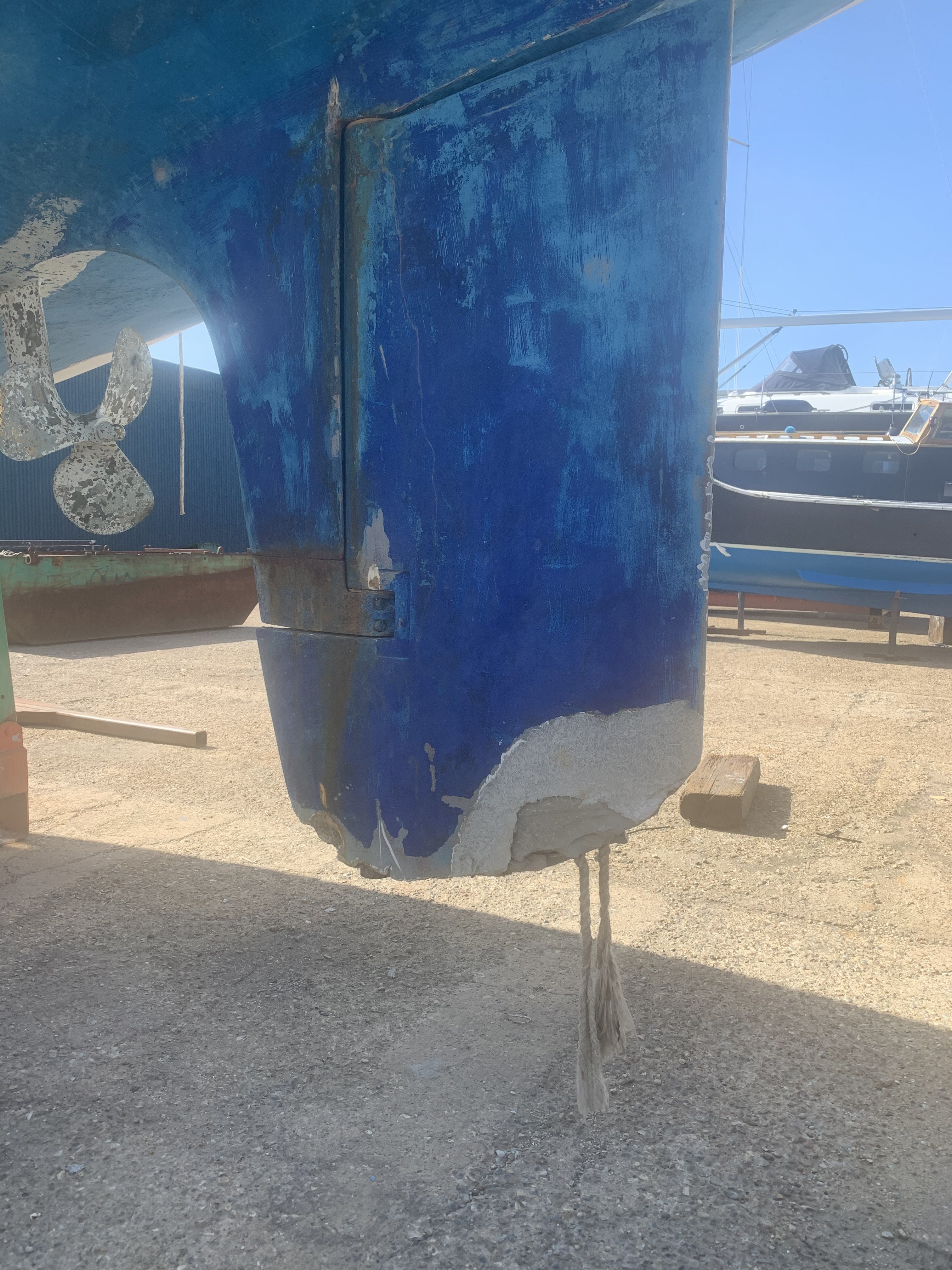

She wasn't fully submerged but on her side on the rocky beach. Skeg looks in one piece (photo attached) but rudder will need some work on it/replacing.
Do you/anyone on here know anyone they'd recommend for such work?

Hi Ollie,
In your position, I would ask the surveyor if you could join him (with appropriate social distancing) while he does the survey It's amazing how much more you can learn this way than by just reading a surveyor's report.
