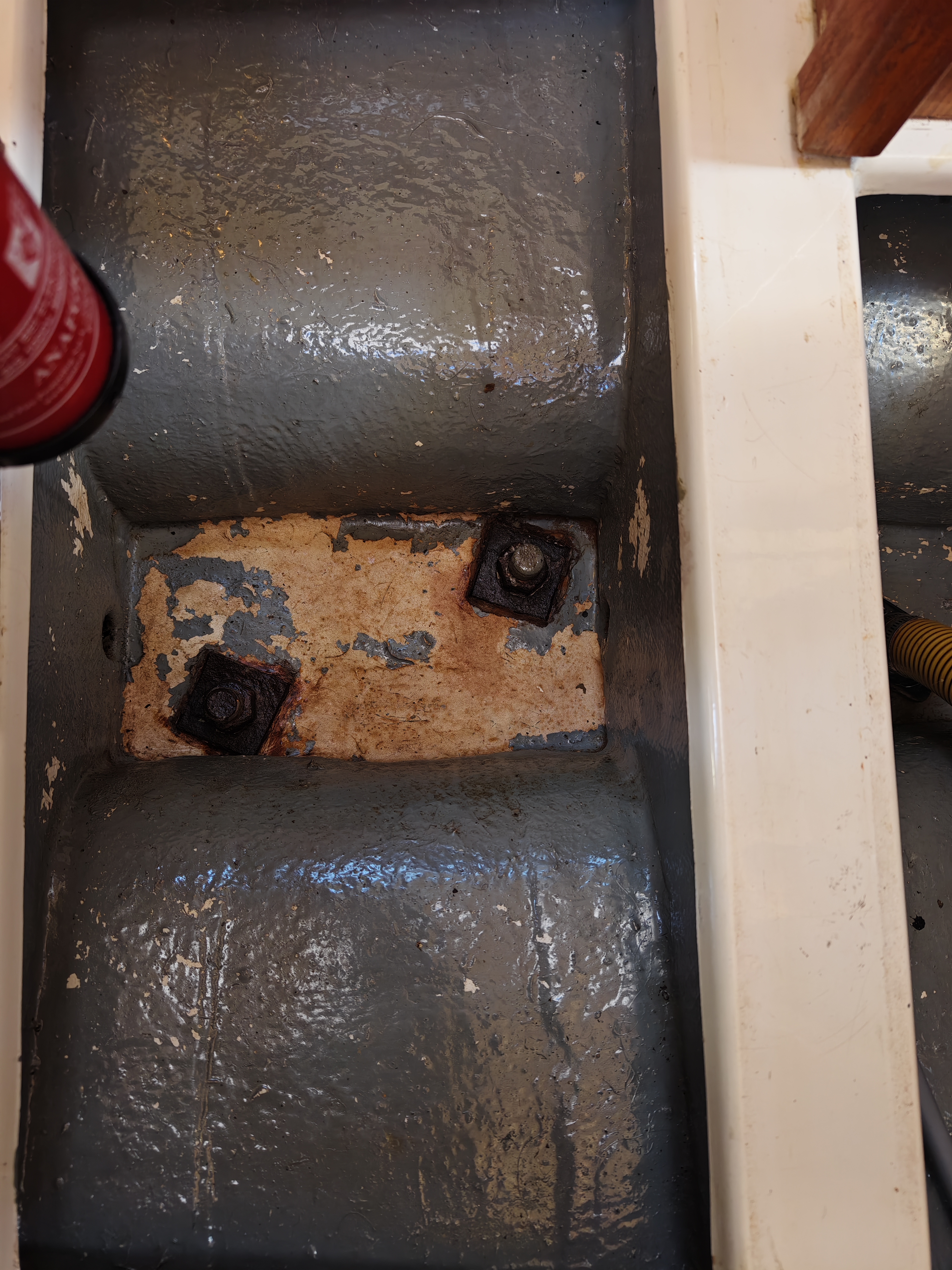

Hello to everyone here. I just signed up for a guest membership because I'm looking at 2 Moody 31 boats, hoping to buy something soon.
I'm quite far away from these 2 boats, so I'm relying on photos before booking by trip to see them in person.
I was wondering if someone here would be kind enough to look at a photo of one of the boat's keel bolts and tell me what they think.
Many thanks in advance,
Catherine
Catherine, given the age of our yachts, they don't look too bad and certainly wouldn't put me off travelling to to view. Be aware that rust normally looks far worse than it actually is, indeed the rust can be 10 times the thickness of the original steel.

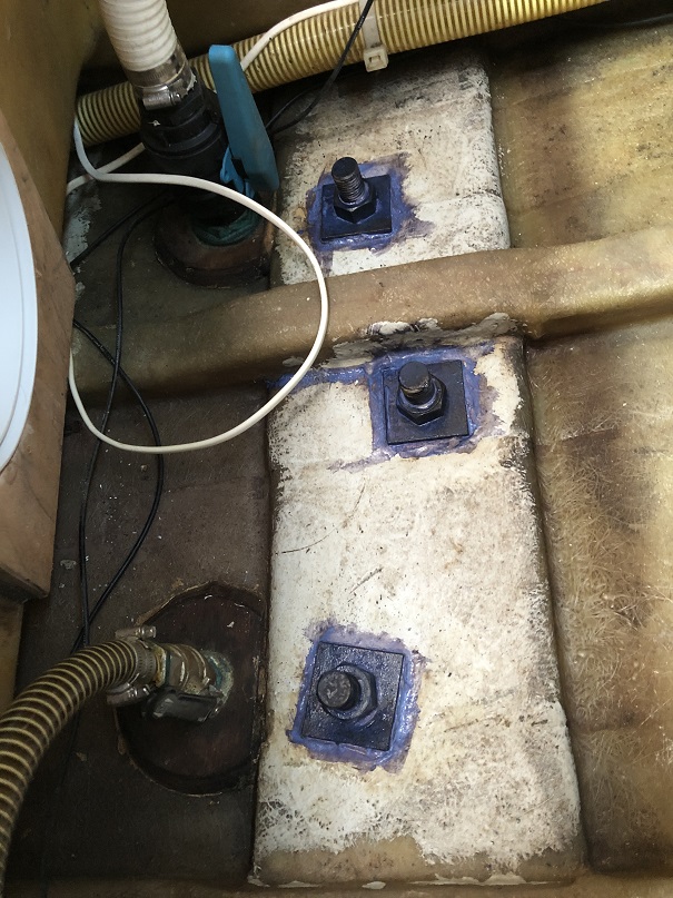

We have a bilge keeled M31, so slightly different arrangement and twice the number of bolts. These are what ours looked like until I tackled them a couple of years ago. The rust was cleaned off using a wire brush attachment in a electric drill. Next a coat of rust killer from Halfords which converts the surface to a hard black finish. Finally a coat of special metal primer and two coats of grey bilge paint from the chandlers.

Pete, thanks for your reply. Those photos are certainly informative! Your bolts look so good now.
The boat that I'm looking at seems to be extremely clean for it's age, so someone must have been taking good care of it, but I have no experience with rusty keel bolts so it's good to see that yours were still OK under the rust layer.

Yes agree with all of that. After rust converter treatment, hammerite paint is a very good and easy to apply protection. And sort out why water getting in bilge in first place. I also have bilge keels so less an issue but still a dry bilge much the better in my humble opinion.

So is it the case that when one sees rust like this, there will have been standing water in the bilge for quite a period of time? It's bone dry right now, so the seller might have just cleaned up really well.
I would say so, however it could have arisen from something, many things, that has been fixed, maybe some time ago. Biggest concern would be that keel to hull join has failed, in which case expensive repair needed, but unlikely. I would talk to the seller about it and see what they know. Amount of rust, which I would say is not an issue but needs sorting, looks an easy fix, must have come from more than atmospheric damp in my view. If the boat is in the water and bilge is dry now then be good to know the story, if they know.

From what hour photo shows, there's not a lot wrong with those keel bolts (actually stds and nuts) that you won't fix with the help of a wire brush on a drill and soe paint. Marine Projects, who built most Moodys, were one of the last builders to move away from carbon steel to stainless steel for keel fastenings, I understand because of concerns about crevice corrosion in stainless steel. A consequence of this is the rusting you observe in a boat where the bilge has not been kept scrupulously dry. However the rust always looks worse than it is because the volume of rust is at least 8 times greater than the volume of steel lost in the rusting process. Once the tops of the studs, the nuts and the backing plates are cleaned up, you will be in a better position to judge the condition of the fasteners. Invariably members who have dawn keel studs for inspection report that the condition of the studs below the nuts is as new completely uncorroded.

The big job which may come out of the keel fastening is a need to drop the keel and remake the keel to hull joint, in which case it's worth replacing all the studs, nuts and backing plates. This is unlikely to be required because of rusting of the carbon steel parts, but would be needed if the hull/ keel joint had failed. The article I linked to in my previous post explains how to diagnose such a failure.

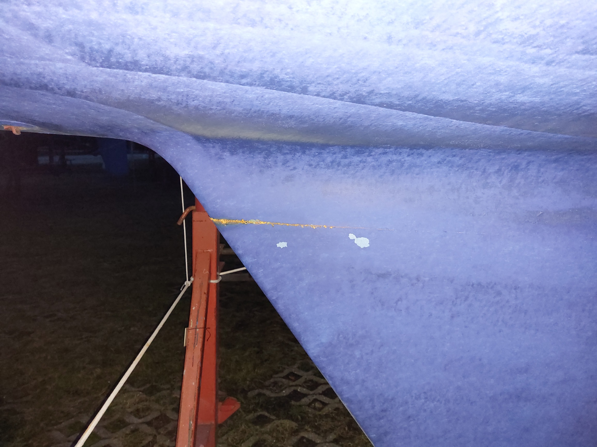

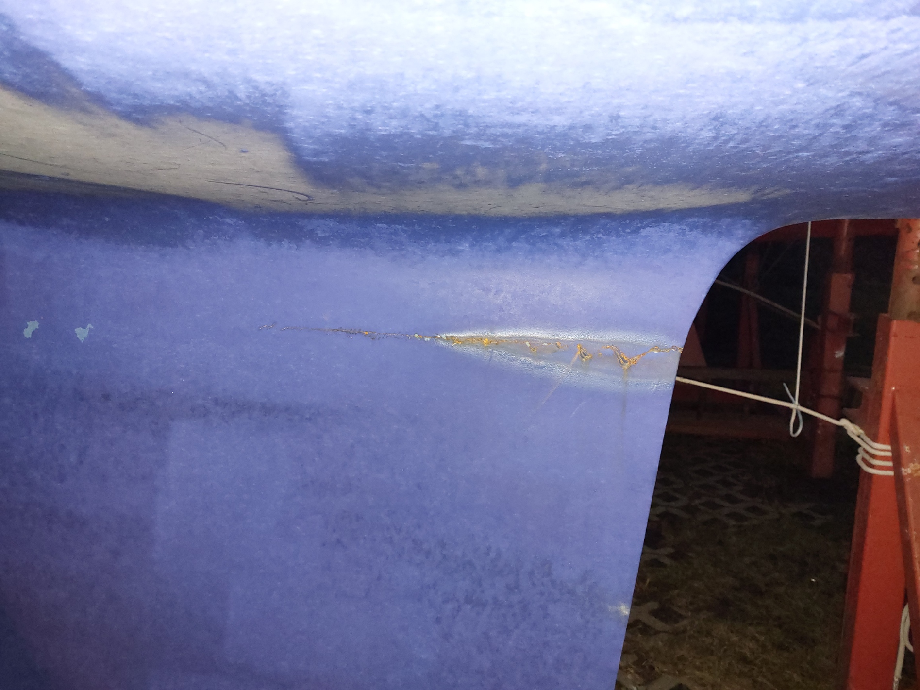

Today I had the opportunity to have a look at the boat. The bolts and washers inside are rusty, but I think not so much that they have to be replaced. My only doubt is about the outside connection of the keel. I attached two photos. In the front and back of the keel you can see rust, the middle part is ok. As a question to the specalists: Is this normal, or could there be a problem with infiltration of water inside the bolts?

For aboat over 30 years old the hull / keel joint is looking remarkably good. The usual way to detect incipient failure of that joint is to observe the boat when her weight is first put down on her keel following lift out If water starts oozing out of the joint it's at least starting to fail. From what I can see in your photo, this boat does not have any major problem with the joint. you can clean off the slight rusting with a rotary wire brush, treat any remaining rust with rust converter, then prime with three coats of Primocon before antifouling.
If the slight rusting is left untreated, it will propagate across the top surface of the keel, eventually reaching the keel studs, breaking the adhesive bond of the keel to the joint. If that is allowed to happen, the only cure is to drop the keel and remake the joint, so preventive action now will save a lot of work.
