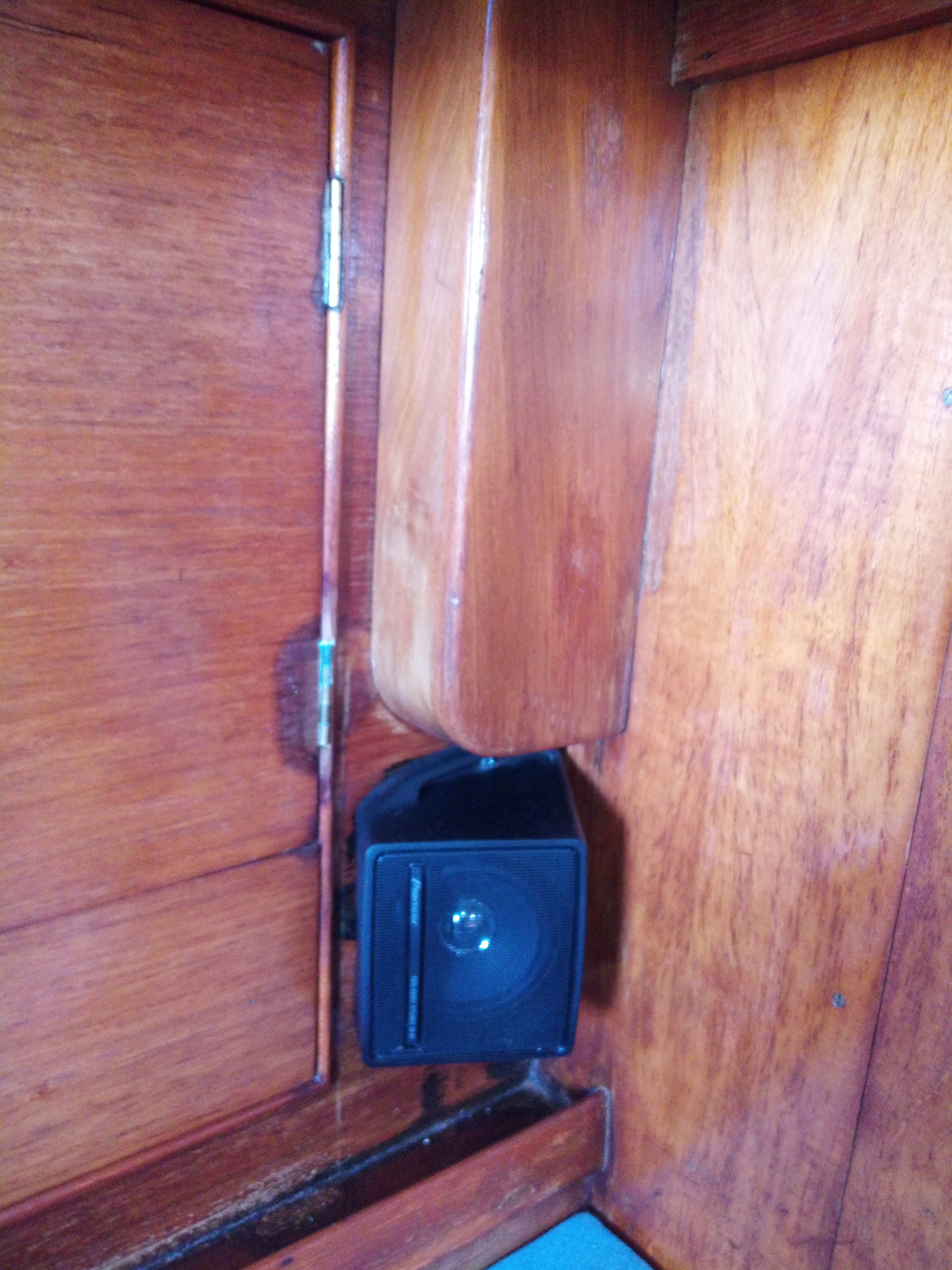

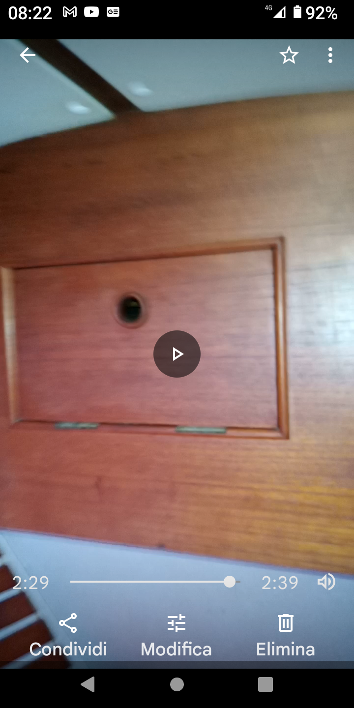

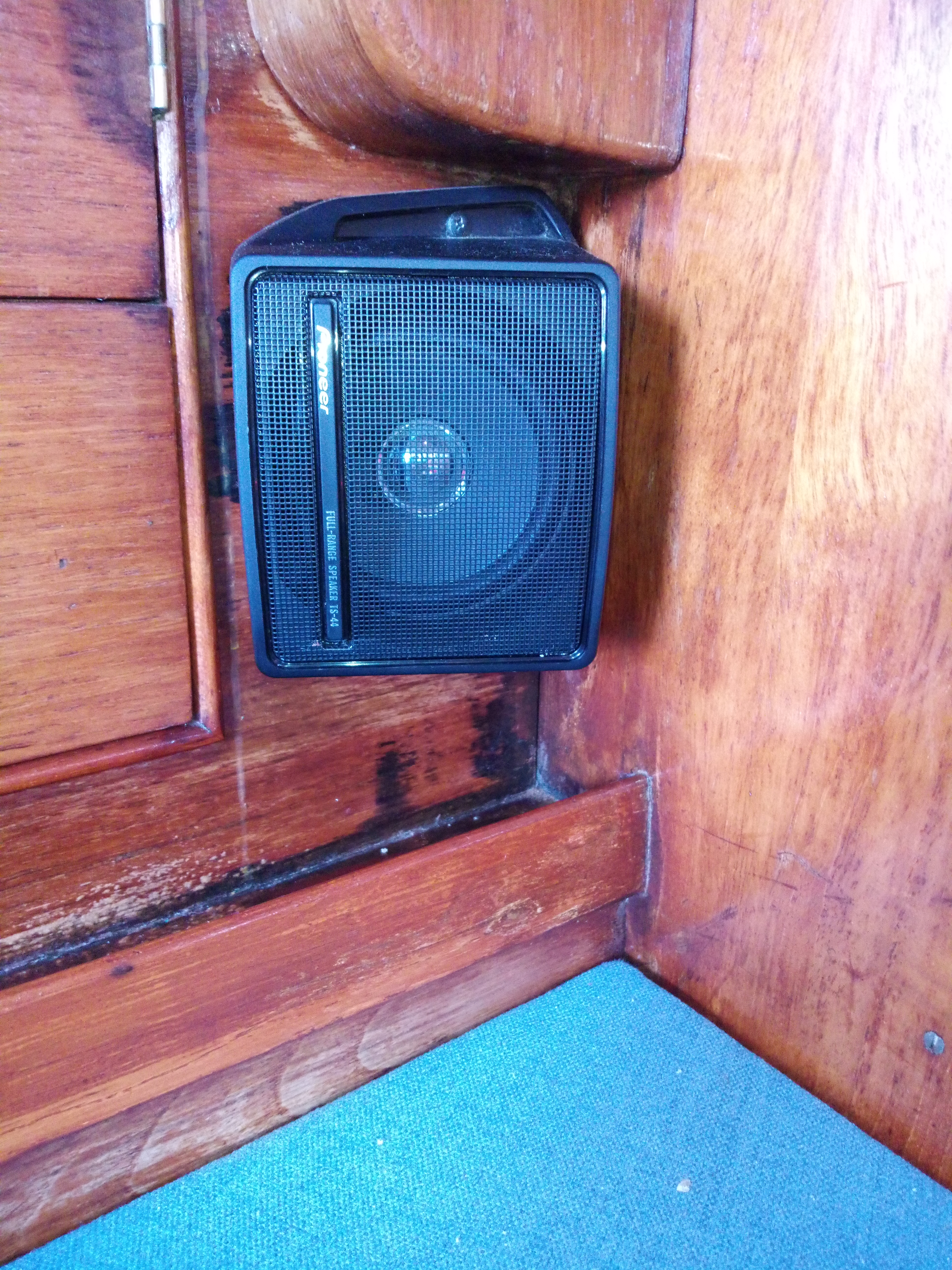

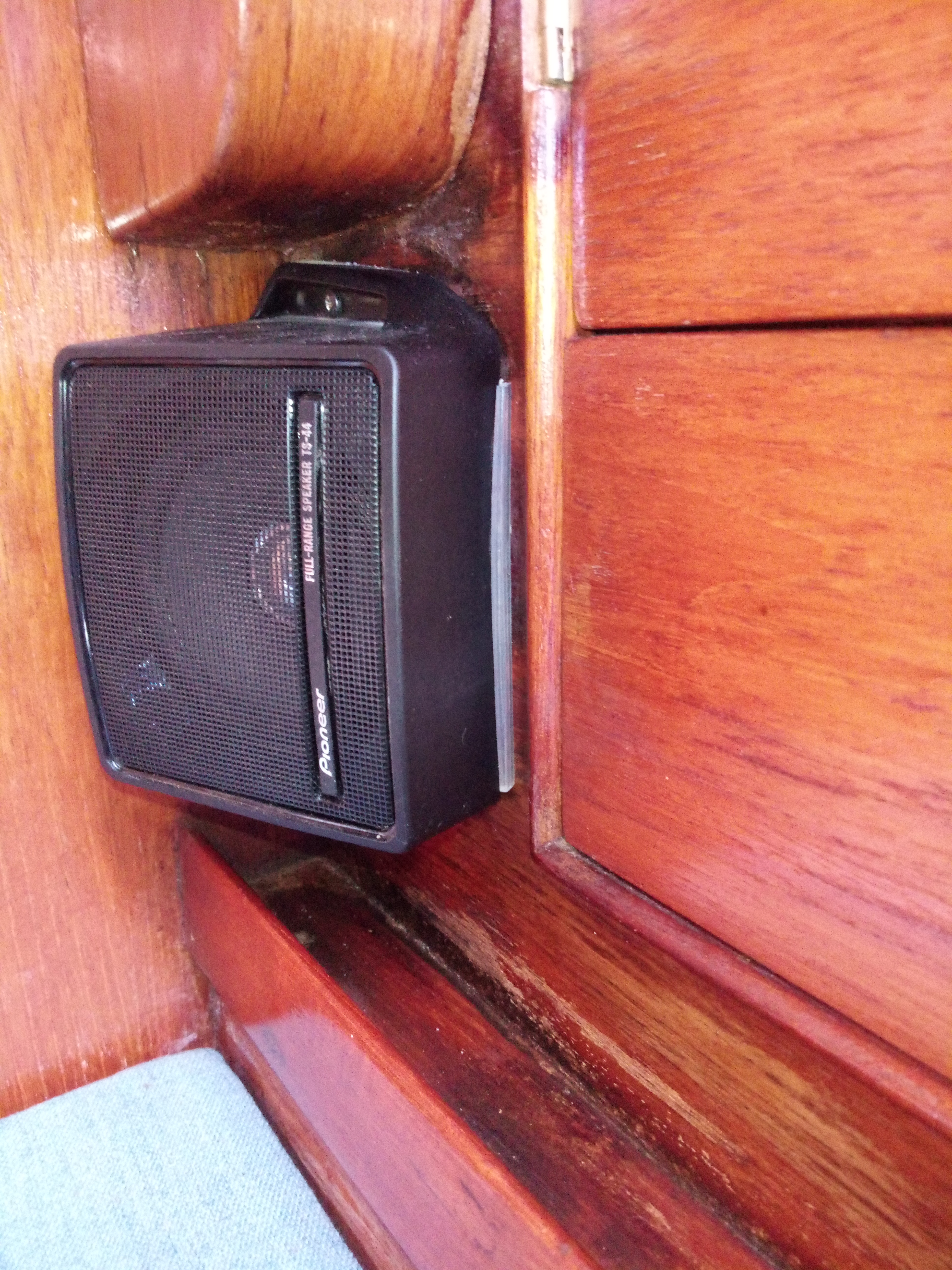

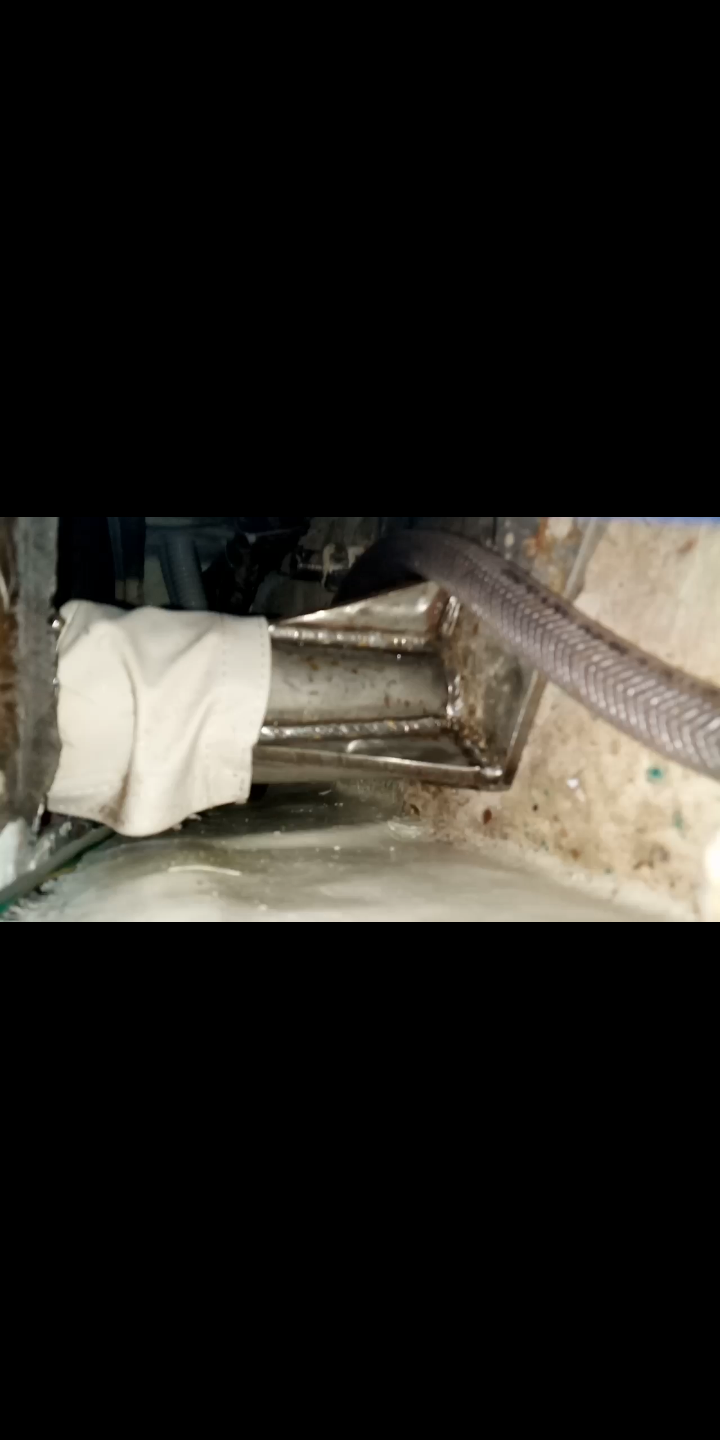

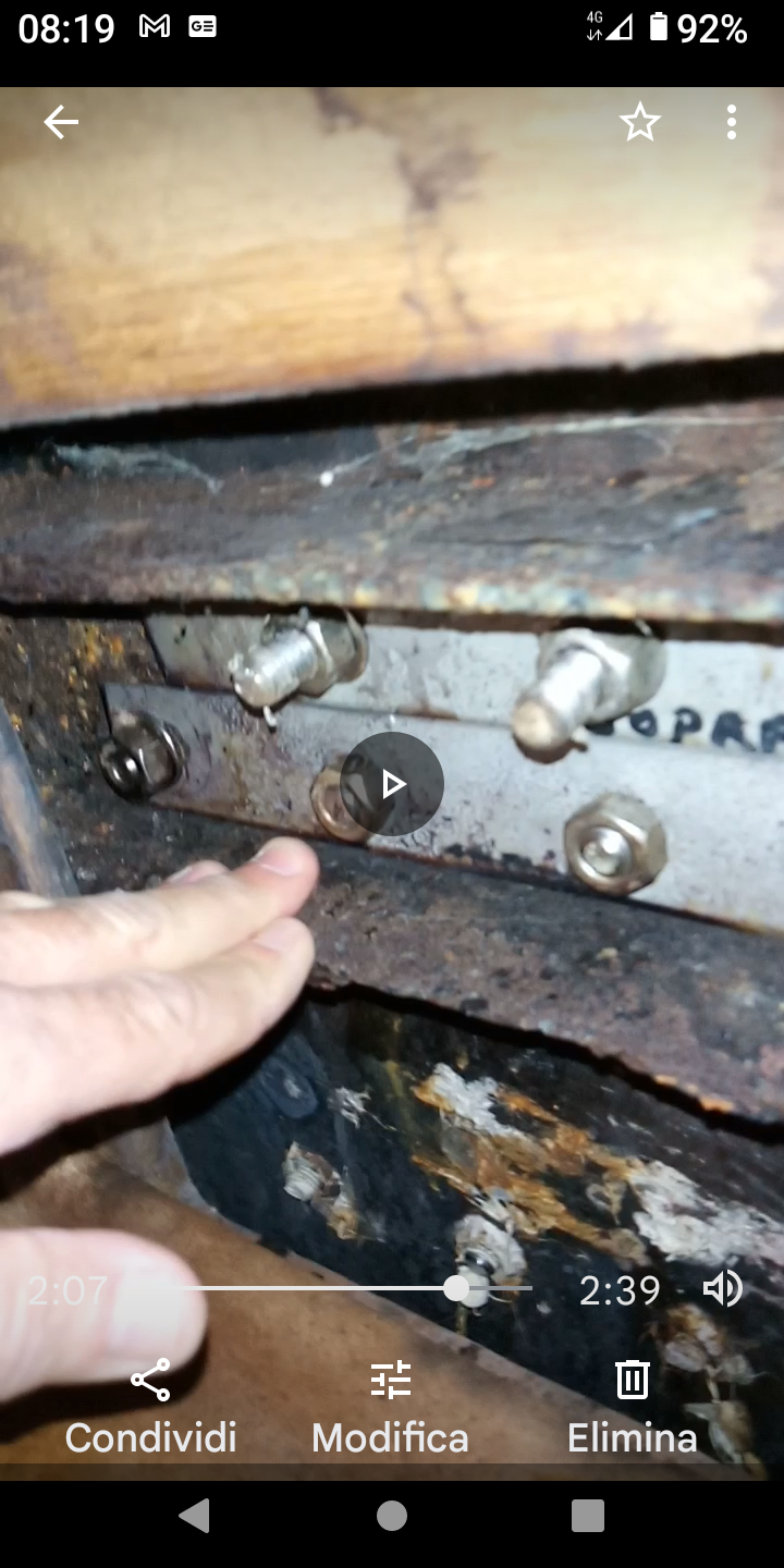

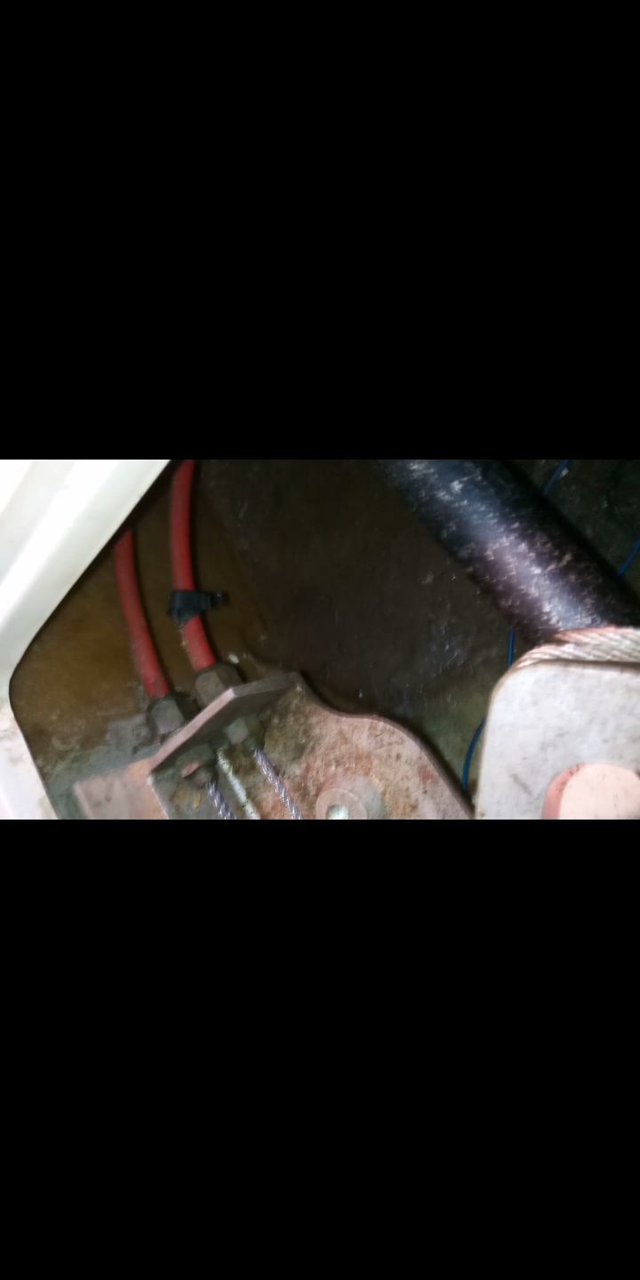

Hi Micky, hi everyone. I have just returned from my second check on the Moody 419. Attached are some photos of the most suspicious areas in my opinion, and others of the correctly maintained areas. Also in the forward cabin there is a hatch, see photo, inside I found a C-shaped plate, which I think is the reinforcement of the second forestay, correct me if I'm wrong, and this is very rusty (unfortunately it's the 'only photo I've lost). Thank you in advance for the comments Screenshot_20230420-193252.png

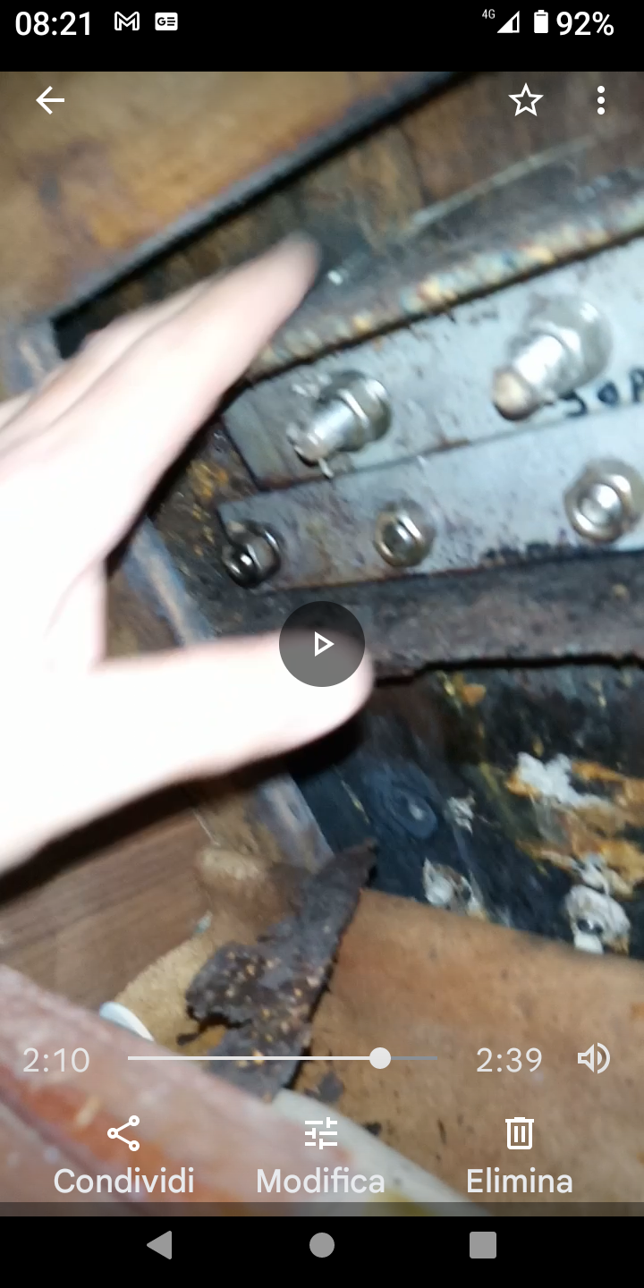

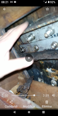

Good morning everyone. I found the photos of the flap. This is what's behind it. Headstay reinforcement?
Enrico, it could be reinforcement for the cutter stay (second forestay) if she is a cutter rig. Or it could be mounting bolts for the anchor windlass (or both). They are both mounted on the same bulkhead I think (I will check mine as mine is a cutter).

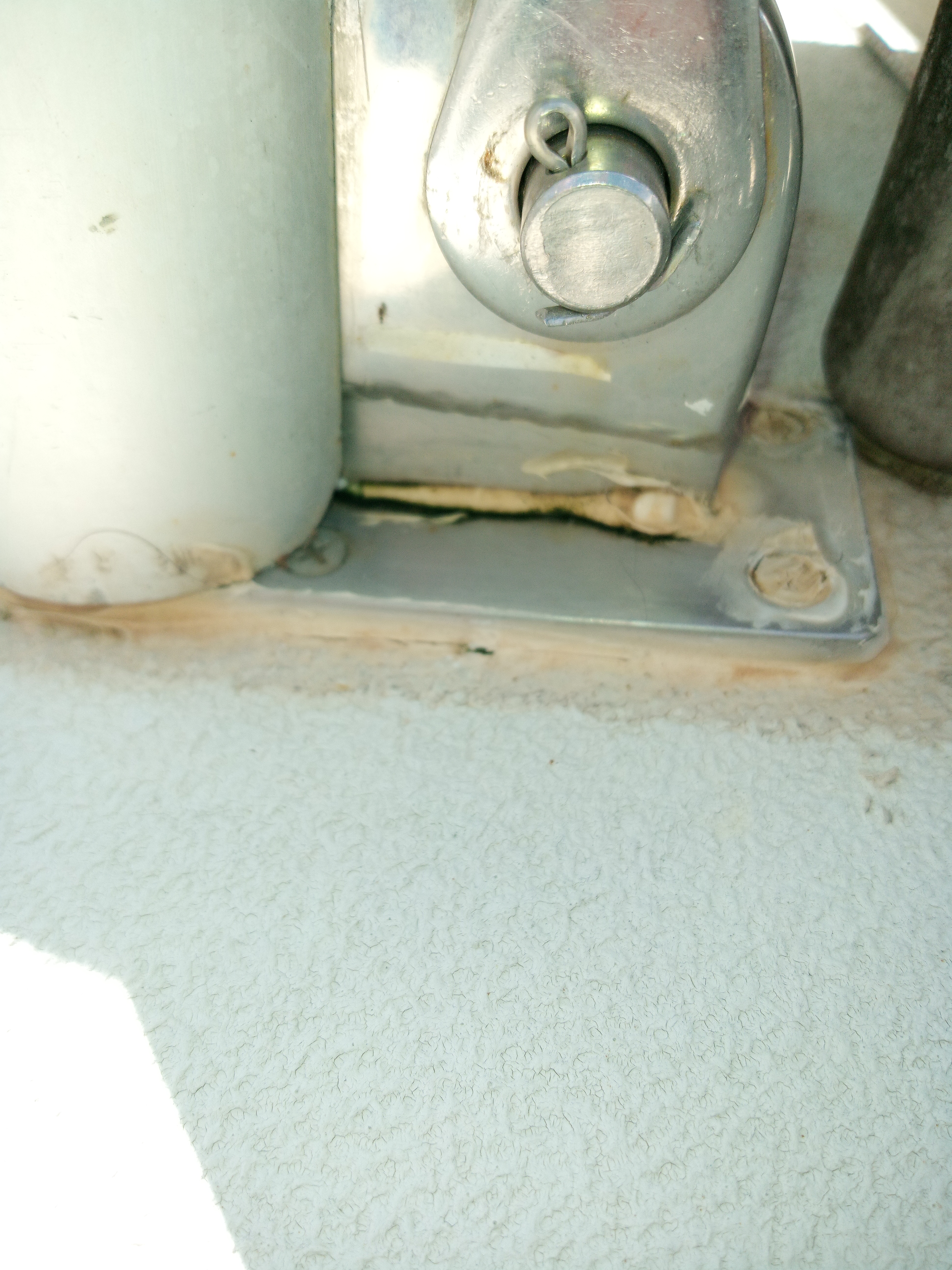

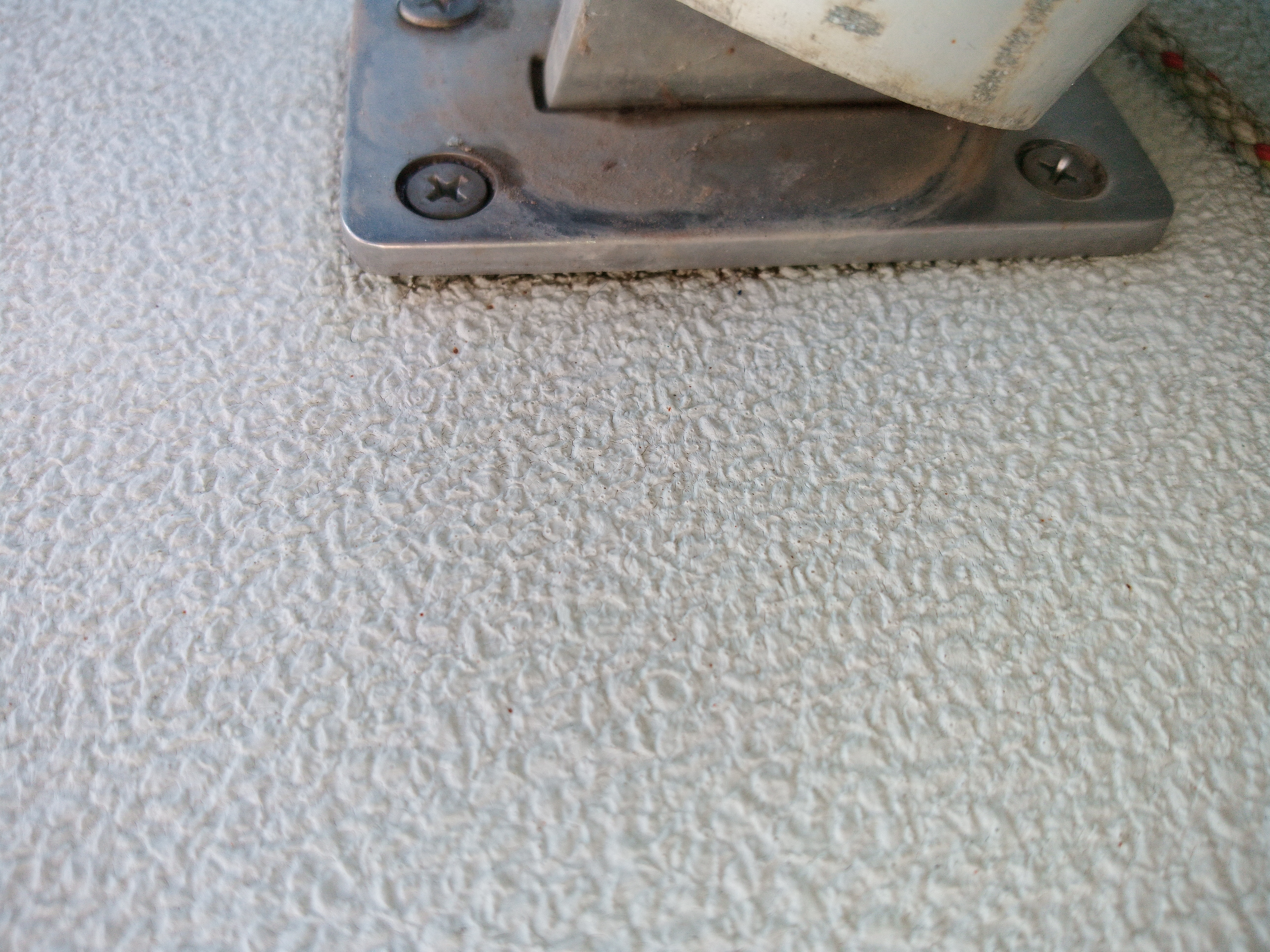

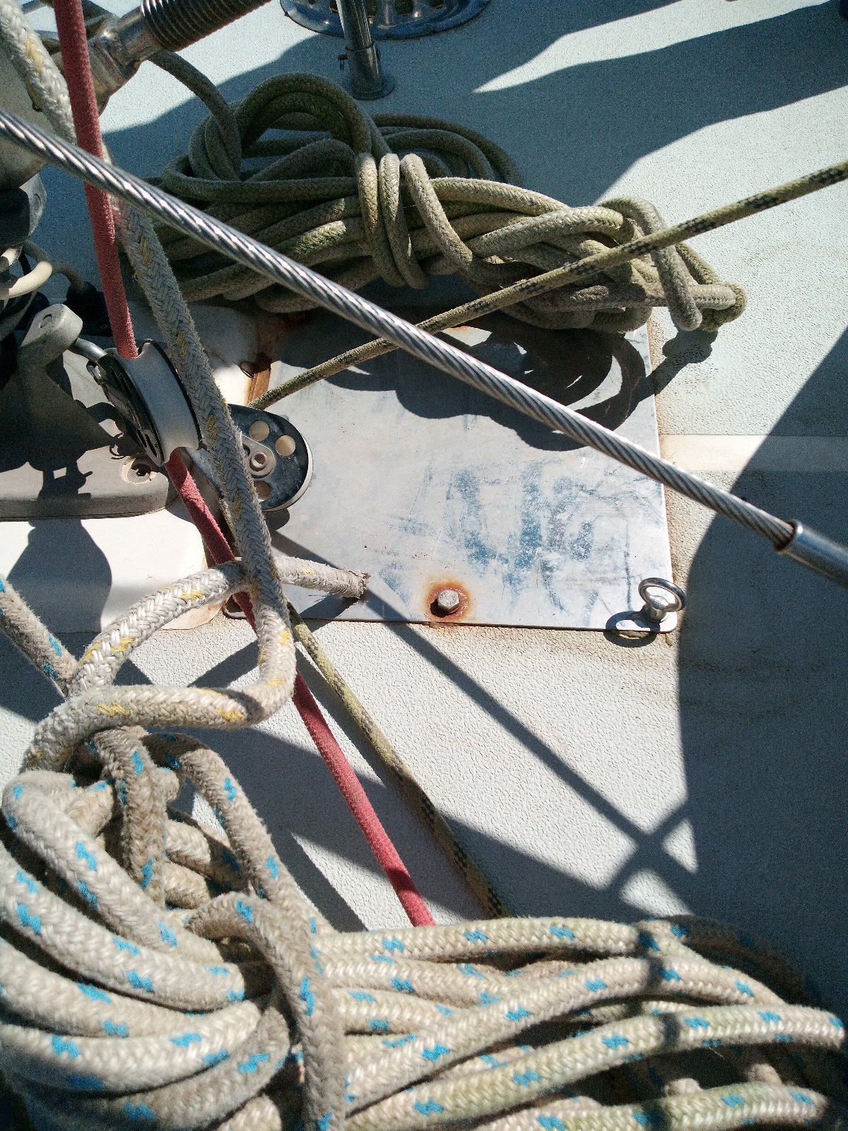

Qualcuno ha idea di cosa possa essere la piastra messa a poppavia dell'albero?
Is more polite if we write in english here, but if you have issues with it just send me a message...
No idea what that plate can be, I don't have one on my 41, but if you remove it what is behind?
Okay I rely on Google for the translation. Thanks in the meantime for your interest. I don't know what's behind it because I'm considering the purchase and will have an appraisal done by a technician in the next few days. I was wondering if it could be a problem with the sandwich and maybe they had put this plate as reinforcement. The only thing is that two screws end in an eyelet and I was wondering if that might make sense. I'm not very familiar with sailing, it would be my first boat. Previously I only had motor boats.
