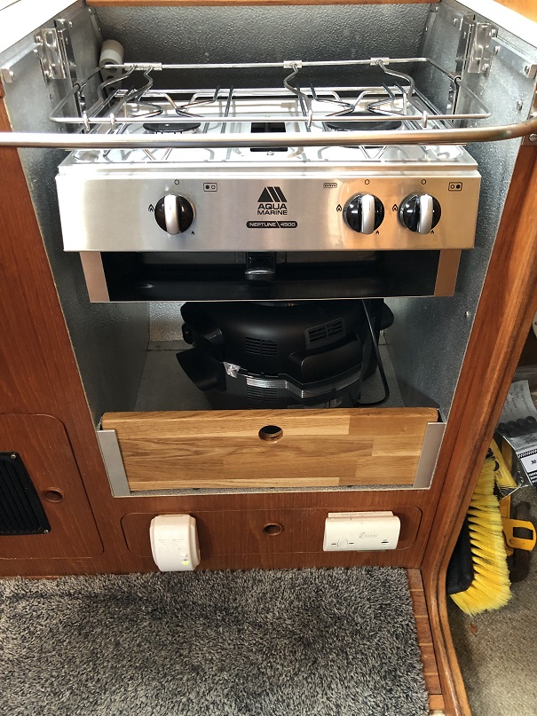

yes she has the hot water system, and it seems to work fine! Not quite sure what route I will take on the cooker, did you replace with another gas or go down the alcohol route?

We replaced the cooker with a hob/grill and a Ninja electric cooker. Did think about alcohol, but Domestic stopped making the Origo range and a good friend did warn me of sooty pans with alcohol.
