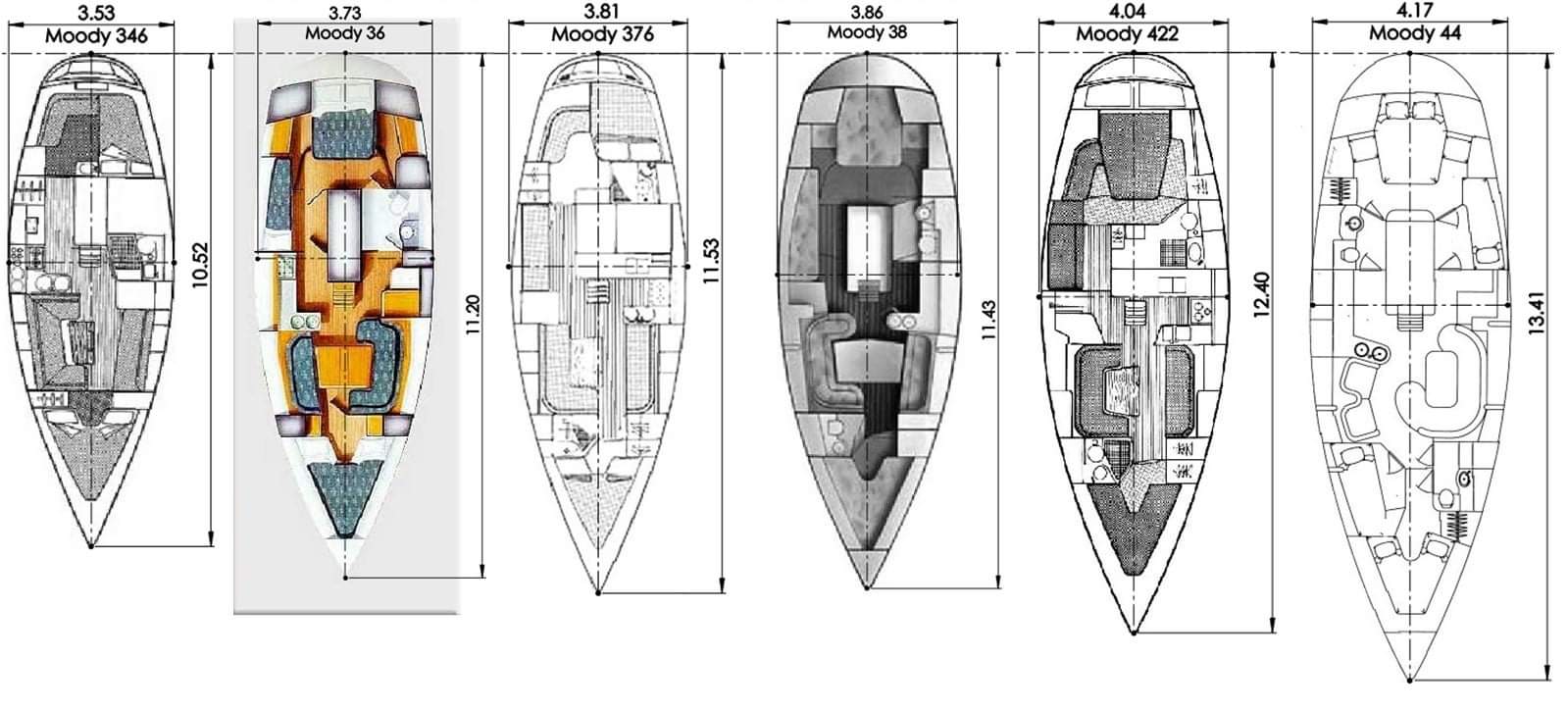

Hi all
Other than only having the one head is the 36 much different to the 38?
Looking at the stats it's only 23cm longer.
While having a second head would be handy for guests and redundancy it's not a show stopper.
I'll be living aboard full time so if significantly smaller / less storage / cramped then I'll cross it off my list.
Anyone living aboard a 36 how are you finding it?

There re two M38's available, the one you have shown built from 1991 - 96 and a later design, built from 2000 to 2003. It is the later one which, in style is more similar to the M36 built from 1996 to 2000. In terms of style, the M38 you have included in your sketches is quite different from the M36 you have included. You need to see, and ideally sail, both types to form your own view as to which you prefer.
Another significant difference between all the boats you have in your sketch is waterline length - this might sound a bit esoteric, but it makes a significant difference to passage times. Moodys are not racing boats, but they do have areputation as passage makers. As one cruising guru one said, there is no substitute for waterline length. The Moody 36 you are considering is 9.24 m. and the 38 you're considering is 9.6 m. hat's worth an hour or more on a passage from the Solent to Cherbourg. The later Moody 38 is 9.787 m., more again, but one of the ways that extra is achieved is less rake in the stem, a change which tends to give a less comfortable motion at sea.

The M38-2 seem really rare, and very few photos available for comparison.
I "borrowed" that picture with the different models from the facebook group and didn't realise the mix up.
