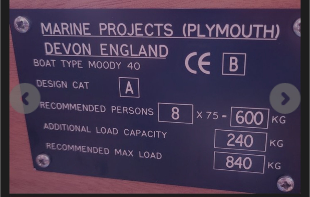

Looking at a Moody 40 (DIxon) and have a few questions. The CE plaque indicates its design category is "A", but then next to the CE stamp there is a B. What is the rating? I know I shouldn't be too concerned about this, more of curiosity. I have seen other plaques where there is a certificate number after the CE stamp, not a letter. This boat looks "A" to me, am I missing something?
