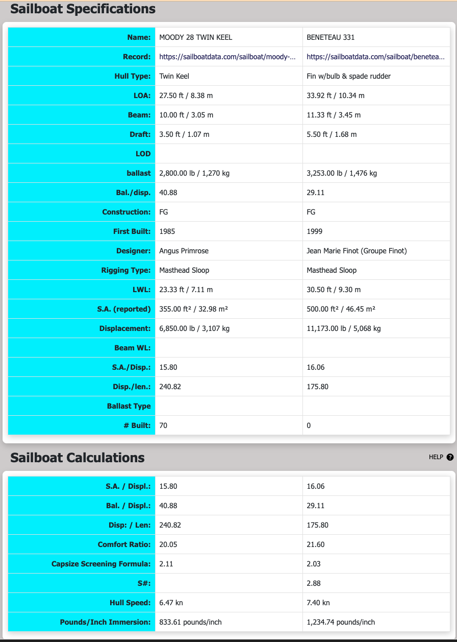

I don't have direct experience of the larger yachts you've mentioned, but I think you'll find that Moodys in general will be comparable in seakeeping ability to slightly larger, but lighter boats like the Jeanneaus and Beneteaus may be.
Others may be able to give more qualified comparisons. As a very crude indication, you can see how some of the key stats compare on something like SailBoatData.com, which can give a clue to how seaworthy the Moodys can be.

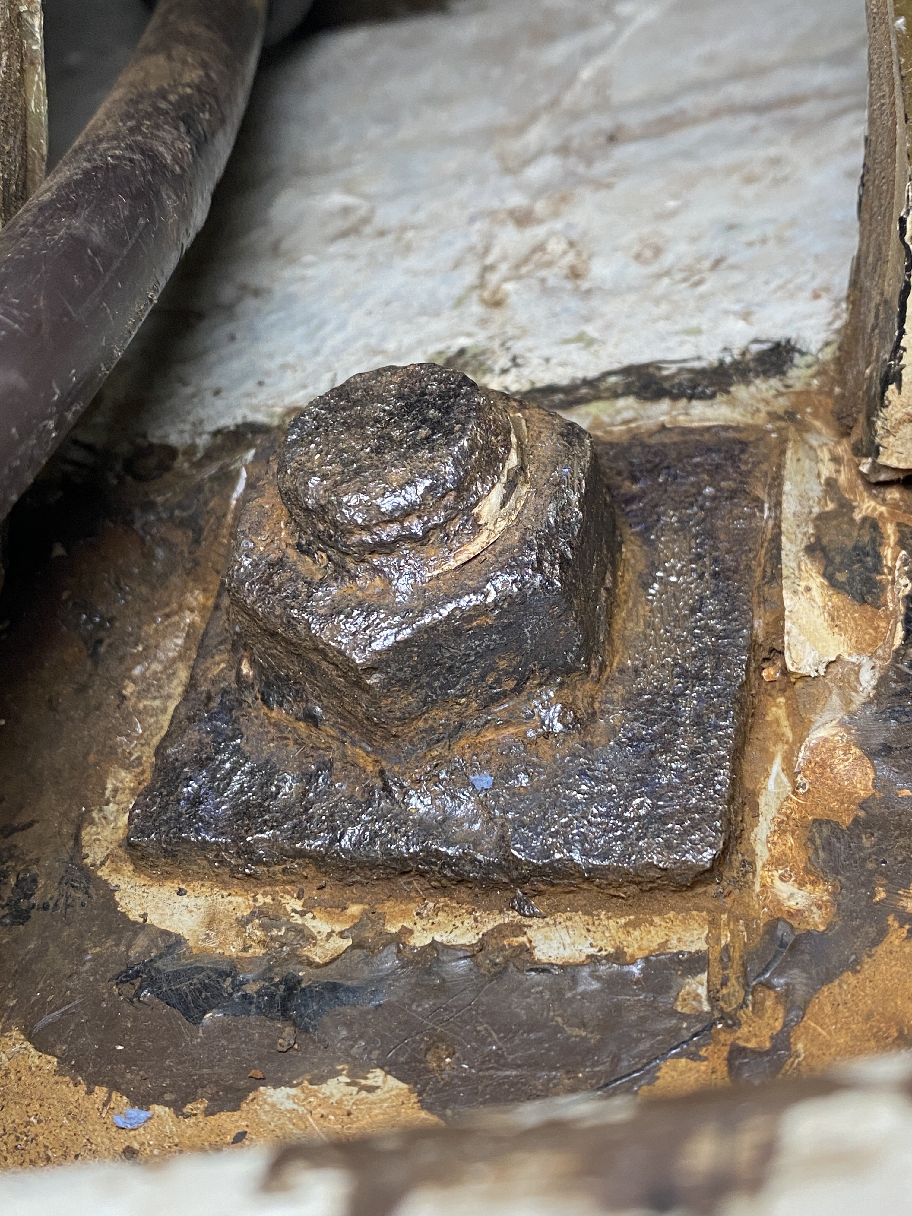

  • Keel bolts are definitely worth checking. Mine are original as far as I am aware, and had clearly been looked after. However where some of the protective paint has been compromised, they look a bit nasty. I have started cleaning them up one by one, and it looks a lot worse than it is. There is often plenty of good steel underneath the nasty looking surface rust. If the bolts have not been looked after, or have been sitting in water for a long time, they may be in a much worse state. The other clue is rust leaking out from the keel joint when it's first lifted out of the water - but you won't be able to check for that tomorrow!
    Many have or will change the keel bolts once they're at this age, but I'm certainly not in a hurry to do it right now and I think that just shows that it varies from boat to boat. Here are before and after pics to provide some perspective.
