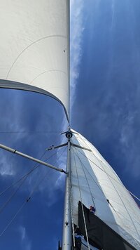

Headsail setup: We have invested a lot of energy installing a suitable deck fitting for an inner forestay. It is not a simple job if you want something suitable for flying a stormsail in an actual storm. We glassed in a new partial bulkhead behind the anchor windlass well and installed a heavily over engineered chainplate system.
We are still working on actual stay and sail arrangement, we have finally settled on a profurl bottom up furling system as used by Florence (see sailing yacht Florence on Youtube). We will be able to fly a heavy weather jib for use to windward and swap out for a stormsail.

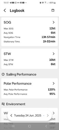

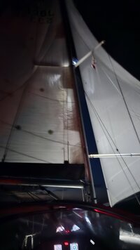

For downwind sailing the 336, as any masthead sloop, requires old school thinking. We use a foreguy and the pole with our 140% genoa extensively. Ragtime is a treat set up like this, able to handle 20kts with the wind upto 20 degrees either side of dead astern. One reef and a few rolls in the genoa and we are surfing in conditions gusting 30kts. This rig is simple and easy to work short handed and really easy to de-power. Foreguy and pole setup and practice really pay off.
Autopilot. We have an old ST4000 Wheel pilot which can handle Ragtime in upto 15kts and slight sea state, beyond that I dont trust it, particularly in bigger seas downwind. We are in the process of installing an internal drive and course computer.
We love Ragtime, and with the right setup I have no hesitation taking her offshore and across oceans.
