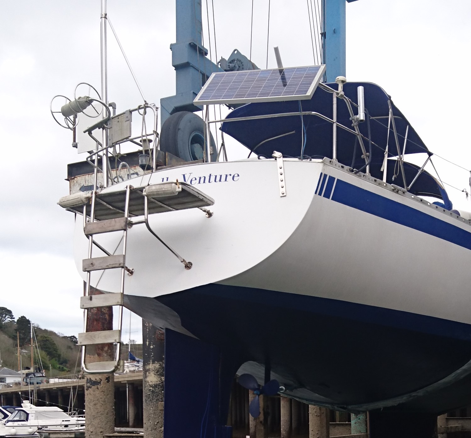

Jeremy, an old picture of Crystelle Venture (a Moody 41, so externally the same as your 419) with the swim platform. It has a fold down ladder, which is in reality a passarelle but as it goes well under the water we use it as a ladder. It is ideal for climbing out of the water.
Yes, it has a line attached that allows it to be pulled down from the water.
it is stainless frame with teak slats.

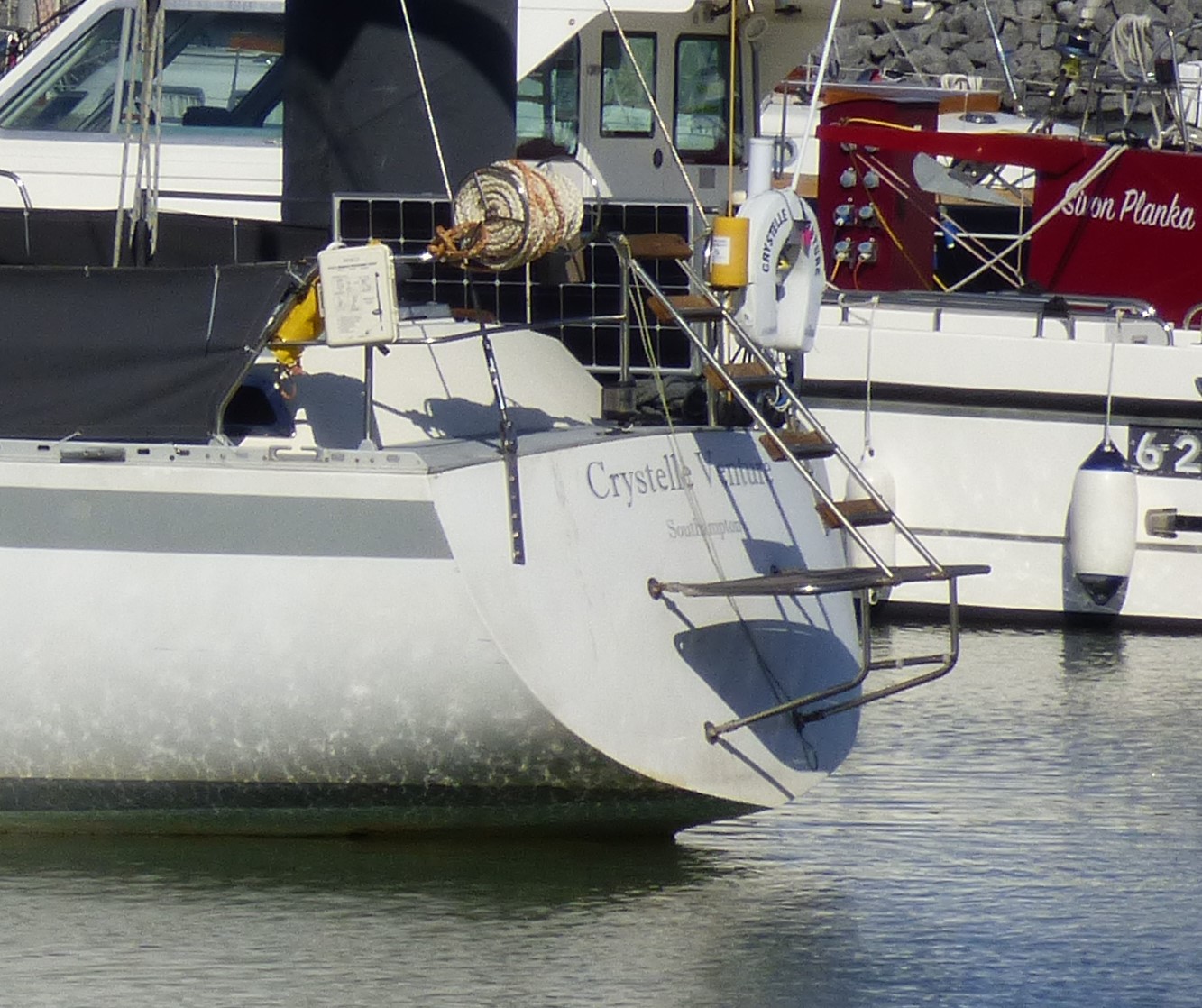

and another more recent
